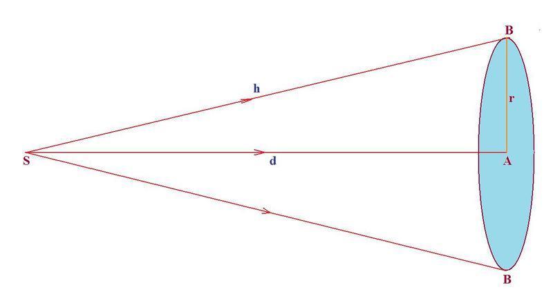

Path difference just refers to the difference in distance that light travels along two different paths. The attached picture shows the illuminated spot from a point source S. Which point of the spot is closest to S and which point(s) is farthest?
A is closest and B is furthest. It seems that I was totally confusing the setup. Also, I guess I did not realize that I could be using ray tracing. For some reason I was stuck with waves in my head.

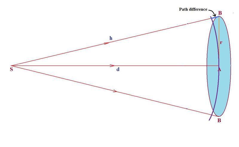

The attached drawing shows a red wavefront just reaching the center of the spot and the path difference is shown in blue.
If the path difference h - d happened to equal one-half wavelength, then the phase difference between the light reaching A and the light reaching B would be 1/2 of 360o = 180o. (One full wavelength corresponds to a phase difference of 360o)
What fraction of a wavelength would the path difference need to be to get a phase difference of 36o?
1/10 of the 500 nm wavelength
Right. So you need to find the distance d such that h - d = λ/10. Hint: express h in terms of d and r using geometry.
