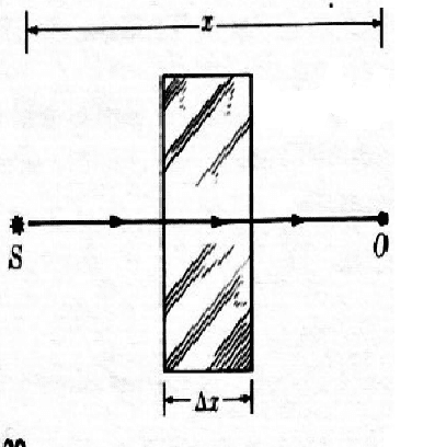

Consider a glass plate of refraction index n and thickness ## \Delta x ## placed between a point monochromatic source S and an observer O, as in picture.
(a) Prove that, if absorption from the plate is neglegible, then the effect on the wave received by O is the add of a phase difference ##-\omega (n-1)\Delta x/c## without changing the amplitude ##E_0## .
(b) If the phase shift is small, (##\Delta x \sim 0## or ##n \sim 1##) prove that the wave received by O can be seen as the superposition of the original wave of amplitude ##E_0## and a wave of amplitude ##E_0 \omega (n-1) \Delta x/c##, with a phase shift of ##\pi/2##.
Diagram of a glass plate of thickness Δx placed between point source S and observer O, with a horizontal ray arrow from S to O passing through the plate; distance from S to O labelled x.
##E(x,t)=E_0 cos (kx-\omega t)##
For (a) I know that there is a path difference between a wave that propagates in air and a wave that propagrates in the plate which is ##n \Delta x## and from this derives a phase shift as in the text. Nevertheless I'm not really sure how can I prove it.
Anyway most of my doubts are about point (b). I find it difficult to understand where to start to prove this fact, any help is highly appreciated

Assume the original wave ##E(x,t)=E_0 \sin (kx-\omega t)##. The glass slab causes a phase shift, so the new wave at O is ##E(x,t)=E_0 \sin (kx-\omega t + Φ)##. Apply the addition law for sin (α+β) taking α=kx-ωt and β=Φ=(n-1)Δxω/c. Use that the phase difference Φ is small, so cos(Φ)≈1 and sin(Φ)≈Φ.
