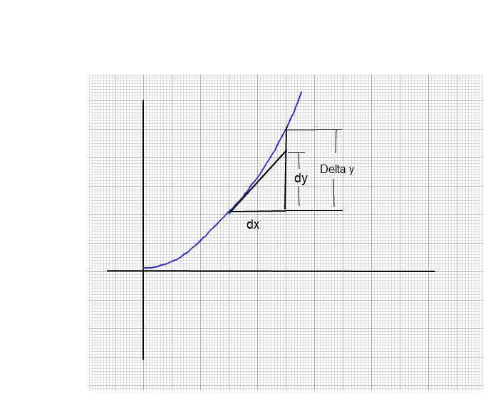

dx is an infinitesimal, while ##\Delta x## means a small, but finite, change in x. In practice, dx and ##\Delta x## are treated as synonomous, but the same is not true for dy and ##\Delta y##.
In the picture below, the blue curve is supposed to be the graph of y = f(x). At the lower left corner of the triangle is the point ##(x_0, y_0)##, where ##y_0 = f(x_0)##. Partway up the vertical line is the distance dy, where dy = f'(x0) * dx. Farther up, the vertical line intersects the curve at ##(x_1, y_1)##, where ##y_1 = f(x_1)##, and ##x_1 = x_0 + dx = x_0 + \Delta x##.
We can estimate ##y_1## using the tangent line, as ##y_1 \approx y_0 + dy = y_0 + f'(x_0) dx##. Notice that because the curve is concave up, our estimate for ##y_1## will be smaller than the true value of ##y_1##, which would be ##y_1 = y_0 + \Delta y##.

No, this isn't right. The change in F is ##\Delta F##. DF/dx is the derivative of F with respect to x.
Let's say we're talking about two points (x1, F(x1)) and (x2, F(x2)), where x2 - x1 = ##\Delta x##.
The change in F is ##\Delta F## (or ##\Delta y## if y = F(x)), the change in the y values of function F. IOW, this is F(x2) - F(x1). This is only approximately equal to dF, and only when x2 - x1 is "small." The picture I drew in my other post shows the difference between dy and ##\Delta y##.
