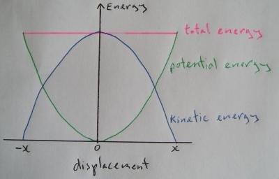

Yes the block stops at maximum compression. The question is not about maximum compression. It is about the compression that happens when potential energy is four times larger than kinetic energy. The problem is easier than you're making it out to be. Besides, your method will fail because you are using equations derived for motion at constant acceleration. That's not the case here. One more thing, the equation you're calling 3rd kinematic equation is actually called Torricelli's equation. There is no equation commonly known as 3rd Kinematic equation.

As shown in the graph I attach in this post, Spring Force evolves linearly. Doesn't that indicate that the Force on the spring is constant and, therefore, so is acceleration?
Interestingly, all 5 steps of my original post yield the same answer as the procedure outlined by Mr. Bridge in post #4.
No, it does not. It shows that the force is proportional to displacement and so is the acceleration.
The spring force varies with position.
Therefore (via F = ma) the acceleration also varies with position.
The block's position is not constant (it moves!), therefore the acceleration is not constant.
Therefore the kinematic equations for constant acceleration do not apply.
