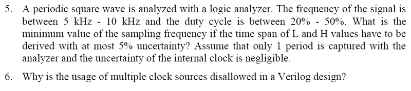

Can anybody confirm whether I solved the problem right or wrong? As for the next question about verilog and many clocks I am unable to find a source with that information. Thanks a lot for any help.
