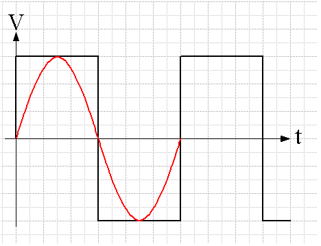

The square wave can also be dealt with by inspection if you picture the largest sinewave that will fit its outline.

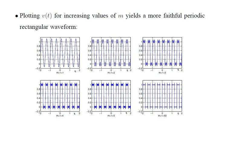

I know from my lecture notes that a sine wave can look like a square wave with squiggles when n becomes a larger number in sin(nx), as seen below:
Do you mean the above in your reply to my question on square wave? :) Just wondering, how do you know how large should the sine wave get into order to achieve a square waveform?
Thanks again! :D

I meant that by looking at a given square wave you should be able to see the period (or frequency) of the fundamental sine wave that fits its shape:
Determining the magnitude of that fundamental frequency for the Fourier series of the square wave is another matter :)
