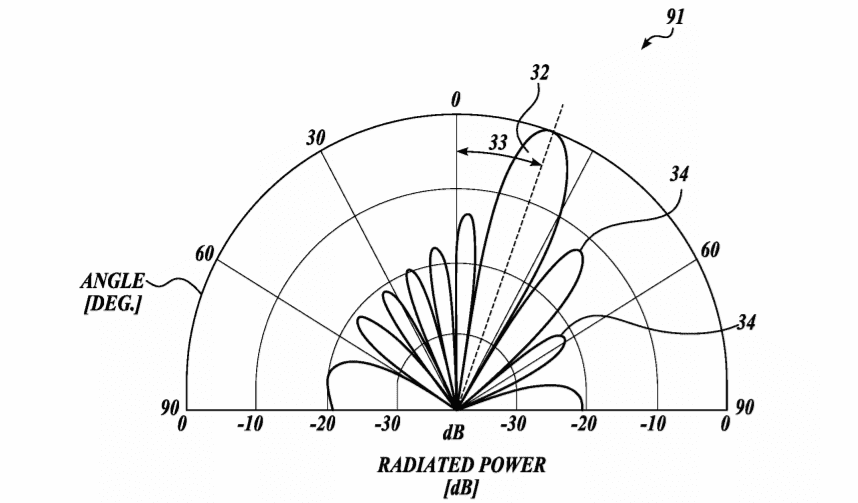

Disassembly of a phased array antenna for Starlink
Starlink has begun its public beta phase, and naturally some people were more interested in the electronics than in fast internet access.
Here is a video how the satellite receiver looks inside. The first half is focused on the mechanical side, the second half is looking at the electronics.
It is a phased array antenna, i.e. hundreds of small antennas that need to be synchronized with picosecond precision. By adjust the delay between the antennas the overall device can track satellites across the sky without moving mechanically.
https://patents.google.com/patent/US10770790B1/en
Abstract
A phased array antenna system configured for communication with a satellite that emits or receives radio frequency (RF) signals and has a repeating ground track in a first direction, the antenna system includes a phased array antenna including a plurality of antenna elements distributed in a plurality of M columns oriented in the first direction and a plurality of N rows extending in a second direction normal to the first direction, and a plurality of fixed phase shifters aligned for phase offsets between antenna elements in the first direction and a gain-enhancement system configured for gain enhancement in the second direction of radio frequency signals received by and emitted from the phased array antenna.
pdf of patent, https://patentimages.storage.googleapis.com/f2/d3/89/e2fec3d1703a51/US10770790.pdf

It's remarkable that they can sell it for only $499.
It's quite likely that they sell it at a loss. Businessinsider claims to have sources that SpaceX bought 1 million terminals for $2400 each from STMicroelectronics. I don't know how reliable that is, but "more than $500" is very plausible. If the $2400 number is true then SpaceX will need to sell ~1.5 years of $100/month service just to recover the loss on the receiver. Subsequent receivers will be cheaper, and SpaceX plans to produce most of them in-house in the future.

It will also be interesting if those phased array antennas will be able to keep a lock for mobile installations. I'm thinking of the roof of a truck or a boat rocking in heavy seas.

Starlink has been tested successfully on aircraft and they have some devices on their ships. They have GPS and can detect their orientation, a bit of movement from a ship shouldn't make a difference.
