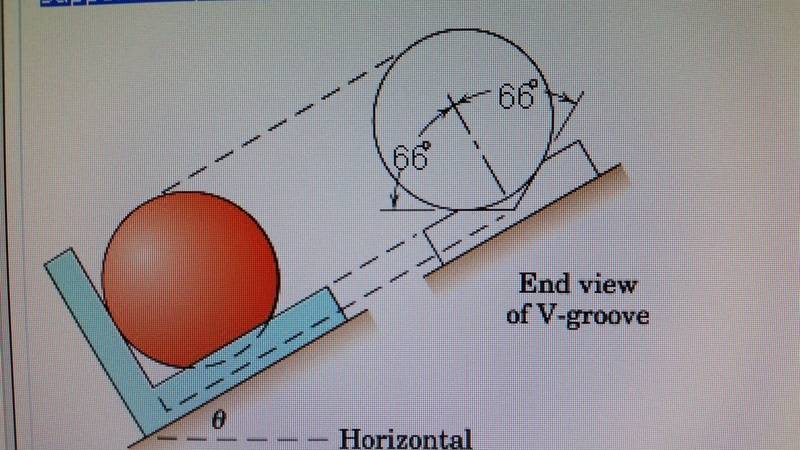

The smooth homogeneous sphere rests in the 132° groove and bears against the end plate, which is normal to the direction of the groove. Determine the angle θ, measured from the horizontal, for which the reaction on each side of the groove equals the force supported by the end plate.

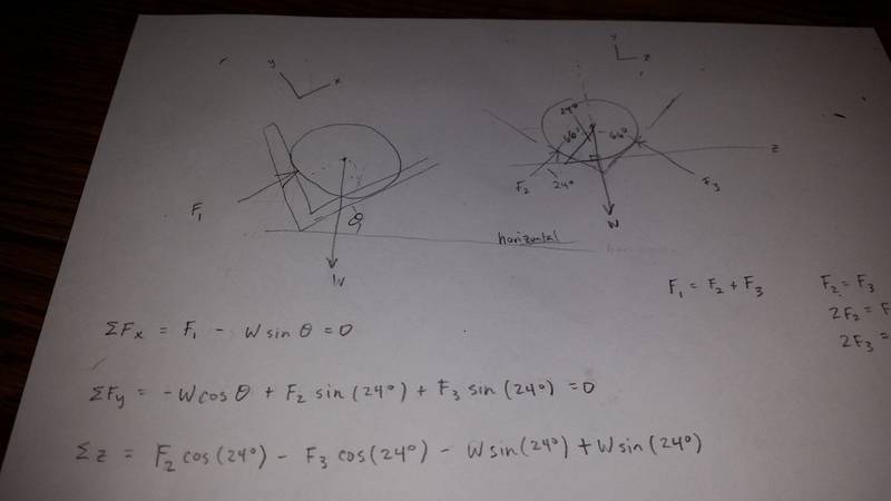

ΣF=0
edit: in the second equation F3sin(24) is supposed to be positive.
Your hand-drawn diagram is wrong, and your equations are wrong for both diagrams.
This is very much a 3D problem. The printed diagram shows two different views of the same thing.
The black and white view is looking down the slope, showing what the groove looks like in cross section.
In the coloured view, the groove is seen side on, running up the slope from the end plate. The deepest line of the groove is shown by the lowest of the three sloping dashed lines.
There are four forces on the ball, the three reaction forces and gravity.

I edited my sketch above. I still have too many variables.
The very first equation there is wrong. You seem to be inconsistent over which way x and y point. The F1 term has x horizontal, while the W term (and the zero F2, F3 terms) has x parallel to the slope.
Similarly in the second equation, y is vertical for the F1 and W terms but normal to the slope for the F2 and F3 terms. You also have a sign error there.
You don't need any more equations. The actual values of the forces don't matter, and cannot be determined. All that matters is the ratios between them.

Edited my sketch again.
Would it be beneficial to solving the problem if i wrote out each force in unit vector notation?
The equations look good now. Don't forget, you also know F1=F2=F3. They're quite easy to solve - no need to go into vector notation.

Yes, sorry, my mistake. But your equation at post #16 is wrong.
In the latest version of the image in the OP, you have, effectively:
##W \sin(\theta)=F##, ##W\cos(\theta)=2F\sin(\alpha)##, where alpha = 24 degrees.
Start again from there, and please post working as typed text, not images.
