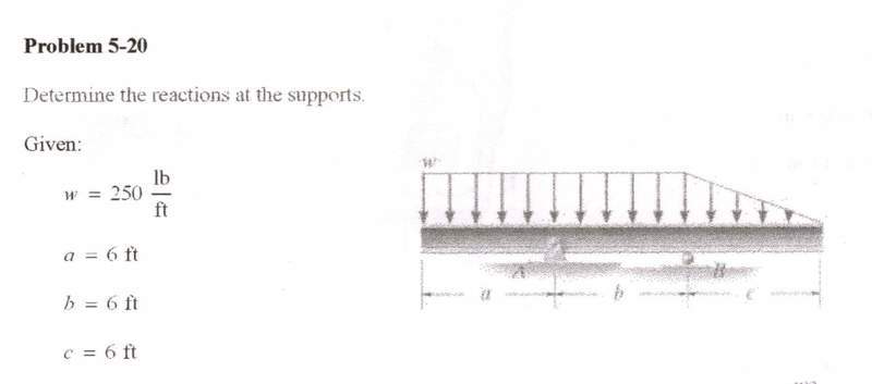

see attachement
sum of Fx=0
sum of Fy=0
sum of M=0
There are 4 forces that I have found. 12W acting in the negative y direction at A. 3W acting in the negative direction acting 2 feet from pt B. A F acting in the positive y direction from point A and a F acting in the positive direction from point B.
Ay+By-12W-3W=0.
Ay+By=3036lb/ft
Obviously I need a second equation to solve for Ay and By. I'm not sure what other forces I can sum up. I think somehow I want to incorporate a moment force but I don't know what it would be.

Hi jimbo71! :smile:
I can't see your diagram yet, so I'm only guessing …
but there's probably no "moment force" - you just choose a point, and take moments of all the ordinary forces about that point, and equate it to zero. :wink:
