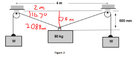

Find the value of W to maintain equilibrium
I have split the system into two, creating a triangle. From this I have a right angle triangle with an adjacent of 2m, opposite of 0.6m and an hypotenuse of 2.088m (calculated through pythag). I have then worked out the angle at the pulley as 16.7 degrees. However I do not know how to now find W, I think it may have something to do with the equation 40kg x g x cos(90-16.7) + 40kg x g x sin(90-16.7), but this isn't given me the kind of answer I expected so I'm not sure if it's right.
Any help on the next step would be much appreciated!
How about analyzing the forces acting at the point where the ropes connect to the 80 kg mass. Apply the conditions for equilibrium.

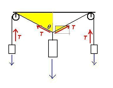

Am I right in thinking the forces are acting like this?
Yes, that's exactly right. And if you set up the equilibrium equations, you can solve for T.
