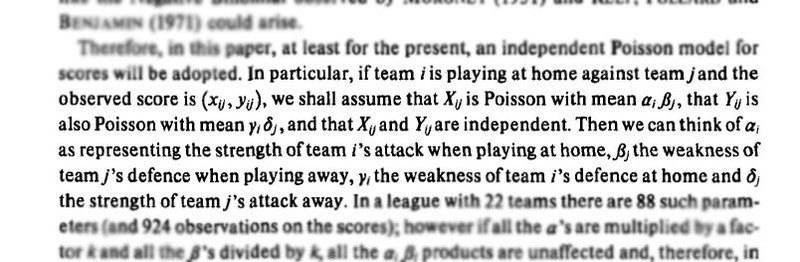

The author claims that, in a football match, number of goals has a Poisson distribution. In the second paragraph of section "2 The Model" the author says:
and at the end of the same section we have some equations for calculating the mentioned parameters:
I think if I calculate these 4 parameters for each team I would have the lambda parameter of the Poisson distribution. Then I should be able to calculate the probability of x=0, 1, 2, 3, 4, etc. goals by each team and after that I just need to pick the x which has the highest probability as the number of goals by that team. If I am wrong please correct me.

Calculating Sx:
You make two nested iterations:
For first iteration go through all the teams using variable i
For second iteration go through all teams using variable j
If the i != j:
You find the goals scored by the i team against the team j when the team i was home team and add it to var Sx...
Author defines xij and yij here:
In particular, if team i is playing at home against team j and the observed score is (xij, yij)
I have not read all the article. Only the line I quoted above to find what is xij and yij.
