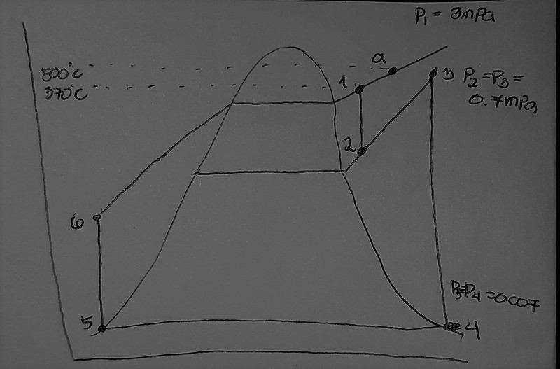

First I made a T-S Diagram
Hand-drawn T-S diagram of a reheat steam cycle with states 1 to 6 on the saturation dome; P1 = 3 MPa, P2 = P3 = 0.7 MPa, P4 = P5 = 0.007 MPa; isotherms at 500°C and 370°C marked.
Based on the diagram above, I got all these enthalpy values.
Spreadsheet list of enthalpy values: h1 = 3162, h2 = 2812.138, h3 = 3481.7, h4 = 2342.431, h5 = 163.4, h6 = 167.041, ha = 3456.5.
h1 = h @ 3 MPa & 370C
h2 = h @ 0.7 MPa & s1
h3 = h @ 0.7 MPa & 500C
h4 = hf4 +x hfg4 (All values, 0.007 MPa)
where x = (s4 - sf4)/sfg4
h5 = hf @ 0.007 MPa
h6 = vf5 (P6-P5)
WP1 = h6-h5
ha = h @ 3 MPa and 500C
The WNet that I got is, 1485.491
For the Qa = (ha-h6) + (h3-h2) = 3959.022
Eff = .3752
Was not able to solve Heat Rate.

It looks to me like h3 is wrong. It should be equal to h2 plus the heat given up by the high pressure stream between 500 C and 370 C. So, it should be about 3100 J/kg.

Thank you for your reply.
Should I get the heat given up by using this formula?
Q=mcT

Sure. Or you can get it from the steam tables as the ##\Delta h##. Both should give about the same answer.

Hello,
We was informed that the label in the schematic diagram that was given to us was wrong. I adjusted my TS diagram based on the correction and tried to solve it again. Thankfully I got the answers now.
