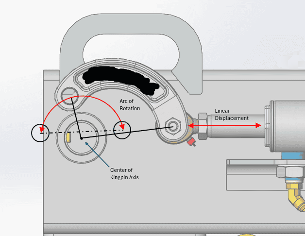

I have completed a motion study using SolidWorks to calculate the force required to steer tires in a certain amount of time. I am crunching numbers to determine the mechanical advantage provided by a steering linkage to demonstrate to my supervisor that the motion study makes sense.
It appears that I am unable to attach any images here, so I'll do my best to paint a picture for you.
I completed a motion study using SolidWorks to calculate the force required to steer tires in a certain amount of time. I am confident in the motion study, but I need to complete a separate calculation to instill confidence in the motion for my manager.
I have completed a lot of work, and the one thing I keep getting hung up on is how to calculate the mechanical advantage. Simple, right? But the design, from what I've seen, is not typical. I have good reason to believe there is a mechanical advantage because the calculated kingpin torque far exceeds what the motion study simulated. The calculated kingpin torque was calculated using the length of the "effective radius arm." The effective radius arm is defined as the distance between the center of the kingpin axis and the line formed between one point and its mirror point on the circumference of rotation parallel to the kingpin axis.
I have a double-ended cylinder attached to a steering linkage on either side. The linkage converts the linear motion of the steering cylinder to the rotational motion of the tire assembly, which rotates about its kingpin axis. However, the linkage does not directly connect to the kingpin - this is the design oddity I alluded to. Instead, the linkage is attached to another pin - call it the prince pin - on the tire assembly that is offset by a fixed radius. It is this pin that rotates itself and the tire assembly about the kingpin.
Now, I am wondering if I have to separate the idea of the lever arm from the that of the effective radius arm. The length of the effective radius arm correlates very well with the simulated changes in force, but it doesn't suffice to explain the torque. One thing that does seem to make the numbers appear reasonable is if I identify the lever arm as being the distance from the kingpin axis to the point where the cylinder attaches to the linkage. Though this makes the numbers seem nice, I am doubtful. The way I see it the, the force applied to the cylinder's pin is transferred over to the prince pin. It is through the prince pin that the force acts on the tire assembly; hence why I'm hesitant to separate the notion of the lever arm from the effective radius arm.
Or could the distance between the prince pin and the cylinder pin be the lever arm? If so, would that make the prince pin a fulcrum and the distance from it to the kingpin the load arm?

The problem you pose is an interesting one, but without a diagram, I am only guessing. It seems you have reduced the problem to a simple linkage analysis. The use of a trigonometric model may fail due to obscured sign changes, while a vector solution may succeed. We need that diagram.
The steering in a vehicle is designed to operate while moving forwards along the road. A model that does not couple the two front wheels through the tire contact patches on the road, and through the steering geometry, will not give a true result.
The radius arm length, is the distance between the kingpin axis of rotation, and the linear axis, along which the force is being applied. The distance must be measured along a radius line, that is perpendicular, to both the kingpin axis and the line of force application. Obviously, the radius arm length will vary, depending on the steering offset from straight ahead.

Okay, I am able to attach the image. As an additional note, in this image, only one end of the cylinder is shown, but on the other end it is attached similarly to the other tire assembly.

chevique said:
It appears that the linkage attaches directly to the kingpin. Not so in my geometry. I attached a picture in the replies.
That oblique line may represent the position at which both wheels are parallel; therefore, Ackerman is there.
The represented piston rotates that left wheel a lesser angle when pushing than when pulling.
Can you show us your Free Body Diagrams for the linkages? It should answer your questions.
