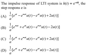

Multiple-choice question: impulse response h(t) = e^(-at) of an LTI system, options (A) through (D) giving step response expressions with terms like (1/a)[e^(-at) - e^(-at)u(t) + 2u(t)].
Use Laplace then multiply in laplace domain then do laplace inverse
Handwritten partial fraction derivation in Laplace domain: H(s) = 2a/(s^2 - a^2) with X(s) = 1/s, Y(s) = H(s)X(s), then partial fractions P/s + Q/(s+a) + R/(s-a), ending with y(t) expressed using exponentials e^(at) and e^(-at).
Handwritten expression: -1/a times (-e^(-at) u(t) - e^(-t) u(t) + 2u(t)), with the bracket closing at the end, written on lined paper with a Page No. and Date box.
Book answer is A
I don't get the first term of eat in option A.[/B]

The way I know how to do this is the time derivative of the step response is the impulse response, so that the integral of the impulse response is the step response. I am a little puzzled by the ## h(t)= e^{-a |t|} ## impulse response function. Normally, I think the impulse response should be zero for ## t<0 ## , or it violates causality.
