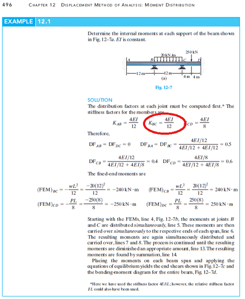

In this question , I don't understand why the KBC is 4EI / L ...
I was told that for the far end pinned or roller supported , the K = 3EI / L , so shouldn't the KBC = 3EI / L.. Is the author wrong ?

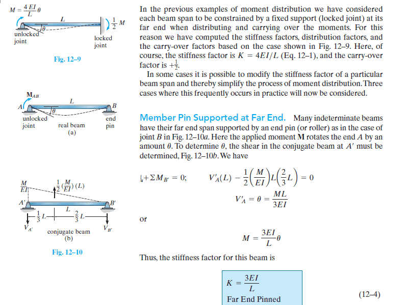

In the 3rd photo , we can see that for far end pinned supported , k = 3EI / L , not 4EI / L
  • Textbook figures for moment distribution: Fig. 12-9 shows a beam with an unlocked joint at one end and a locked joint at the other; Fig. 12-10 shows a real beam with a pin at far end B and its conjugate beam with supports V_A' and V_B'; plus the derivation K = 3EI/L for a far end pinned member.

BC is only a segment of the beam ABCD. The "far end" of BC from B is D.
Think about it: if D were just a pin then the beam could rotate a bit about D, allowing it equally to rotate a little about C. But with D fixed, it is much harder for there to be any rotation about C.

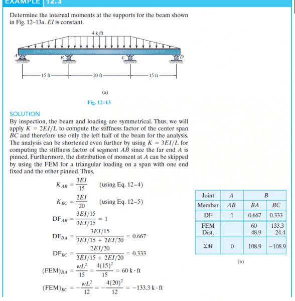

So , in this problem , the far end of AB is D , as D s pinned , so the KAB is 3EI / L ? If D is fixed , then KAB would be 4EI / L ?
  • Textbook example figure: a continuous beam with supports at A, B, C and D under a 4 k/ft triangular load, spans 15 ft, 20 ft and 15 ft, followed by the solution with stiffness factors and distribution factors and a moment table.
That's my understanding. But please bear in mind that my entire knowledge of the subject comes from the textbook extracts you have posted.
