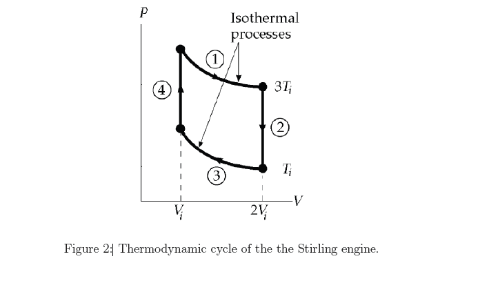

Figure 2 represents a model for the thermodynamic
cycle of the Stirling engine, patented by Scottish clergyman Robert Stirling in
1816. The engine operates by burning fuel externally to warm one of its two
cylinders. A xed quantity of inert gas moves cyclically between the cylinders,
expanding in the hot one and contracting in the cold one.
(a) Consider n mol of an ideal monatomic gas being taken
once through the cycle in Fig. 2, consisting of two isothermal processes
at temperatures 3Ti and Ti and two isochoric processes. In terms of n,
R, and Ti, determine Q for the complete cycle.
(b) What is the eciency of the engine? (Hint: The heat QH
transferred into the system happens during steps 1 and 4).
Figure 2:
