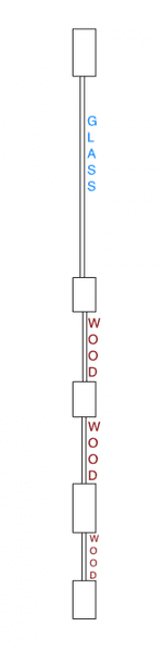

Can you doodle a cross section of the door for us?
As in, if you opened it, and looked at it edge on, what would the average thickness look like?
Mine looks like this:
Edge-on cross-section sketch of a door showing layers from top to bottom: a thin blue-labelled GLASS pane, then WOOD, WOOD and a thin wood layer, with rectangular blocks marking the frame and panel joints.
The glass and thin wood panels are almost worthless as far insulation goes.
I would describe them as "very good candidates for a heat exchanger".
I solved the problem by installing window shrink insulation over both the window and wood panels.
