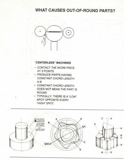

you left out the critical factor of design.
How round are each cylinder? you have a 50 micron gap that is huge. How round is each part. This must be known before any assembly, let alone stress analysis can be made and contact area.
Try fitting a hydraulic connection in a fracking application with 15,000 psi pressure and think you will not have blow by in the connection, let alone any stress analysis .
How round are they? What is the out of roundness ? I am not talking about diameter. I need to know the FORM ERROR.
1970 chevy vega with aluminum block and cast iron cylinders...case in point. How round are they? not by diameter as this is not form error, but size.
Roundness is 50micron.
If the parts are assembled with no force required, and have similar thermal expansion coefficient, then the question, I think, what is the effect of adding glue between them, with high thermal expansion coefficient.
The parts are rigid, and the glue is polymer. Can it cause significant stress?
you can not analyze cylindricity with only a size measurement. you must know the form error of both diameters otherwise it is a waste of time.
