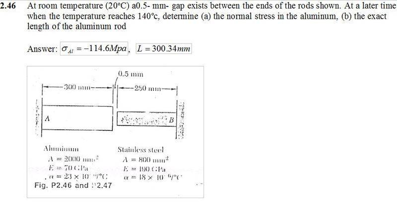

in the following problem
i know that ΔT=120
now the maximum deflection is 0.5mm so i looked for the total deflection had there been no restrictions
ΔL(aluminium)=300*(23e-6*120)= 0.8280
ΔL(st steel)=250*(18e-6*120)= 0.5400
this is clearly more than the maximum deflection of 0.5- there are 0.868 "extra" which cause the stress.
now putting this all together is where i get stumped.
F=ε*E*A
and ΔL=ε*L
F(aluminium)=ε(al)*(70e9)*(2000)
F(steel)=ε(s)*(190e9)*(800)
ε(al)*300+ε(s)*250=0.5
now the force in the aluminium and in the steel must be equal so i have 3 equation system to solve, after solving i get
F= 1.3201e+011
ε(al)= 0.942928e-3
ε(s)=0.868486e-3
now simply using
σ=ε*E or σ=F/A
σ=ε*E
=0.942928e-3*70e9
=66004960
but the correct answer is -114.6MPa
i can see where this might be wrong, nowhere in my stress calculations do i take into account the amount that each material expands. but i have no idea how to fix it
think i got it,
ε(al)*300+ε(s)*250=0.868
