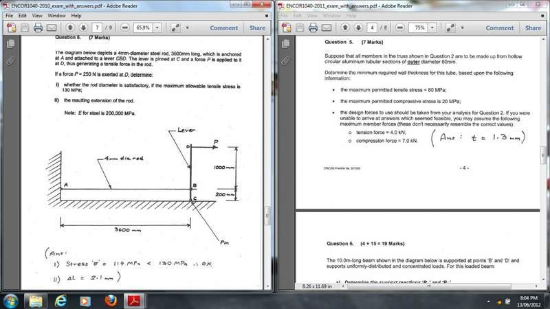

Hi guys i have a exam coming up soon and stress is starting to kick in. I am good withy stress and strain, but just confused on this two questions and don't understand what I am doing wrong. I've tried every formula and i just can't seem to get question 6 out. And question 5 same problem i understand they are similar queations but this one has tensile and compressive force given to you and i don't understand what to do with them. I can upload question 2 help with Q5 but i don't it will help mush its just a truss. The two questions are in the attachment. The answears for this questions are underneath the question.
Please have a look at them and tell me what you think, it will also be much appriciated if can write down a solution for them.
Thanks, Dom

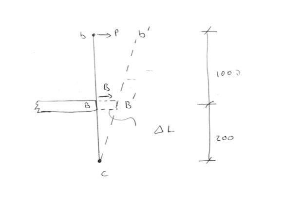

Perhaps this sketch will help.
The end of the bar not attached to the wall is cranked out by the lever so that
b moves to b' and B moves to B'. Thus B moves a distance ΔL equal to the extension.
What is the moment of P about C (you have this correct)
What is the moment of B about C ? You should not think in terms of the wall reactions but about the force, B that is acting (in which direction) on the bar.

OK let's start at the beginning.
The lever is pulled to the right at b with horizontal force P.
The vertical (perpendicuar distance) from the line of action of P to a pivot c is 1200.
So the moment of P about c is 1200 * P clockwise.
The lever is attached to the bar at B so pulls the bar to the right with force B.
Thus the bar pulls the lever to the left with force B (by Newtons Third Law - Action and Reaction are equal and opposite).
B is a horizontal force (like P)
OOPs! So acting on the edit: lever [STRIKE]bar[/STRIKE] is a force B to the left.
The vertical or perpendicular distance from B to the pivot is 200
Since B on the lever is to the left, the moment about c is anticlockwise and equal to 200 * B
Thus 200B = 1200P :
If you insert the given value for P can you now find B?

Hi yep that's good thankyou, i had that before but i thought B=1500 but i thought it was to big. Do you have a suggestion on how to procede from here because this is the spot where I am actually stuck given that i did the same as you before.
OK so now considering the bar.
The bar is extended ΔL by a force B = 1500N
Now that you have the force you can calculate the stress. Make sure you know the difference between the diameter and radius (a common error)
[tex]Stress = \frac{{Force}}{{X\sec tionalArea}} = \frac{{Force}}{{\left( {\frac{{\pi {d^2}}}{4}} \right)}}[/tex]
Once you have the stress you can use it to find the extension using the definition of E and the length of the bar that was given.
[tex]E = \frac{{Stress}}{{Strain}} = \frac{{Stress}}{{\frac{{Extension}}{{OriginalLength}}}}[/tex]
If you make the substitutions you will recover the answers you pencilled in at the bottom of the question.
Hi i got both of the answears out and they are both right thankyou. Do you think you have time to help me with the 2nd question?
