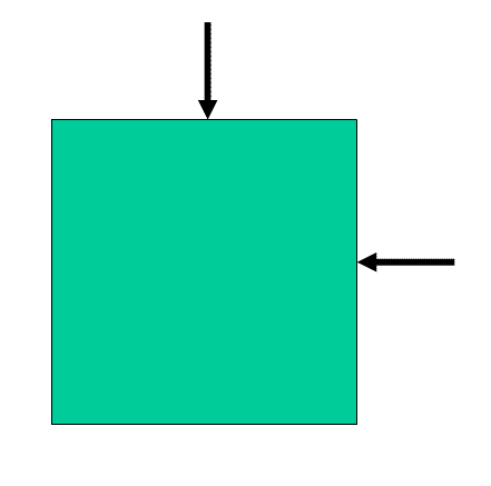

I'm trying to simulate linear elastic deformation on a square flat plate using the finite difference method. The plate is of size 1x1x0.1. So it has 2 square faces and 4 long rectangular faces. The 2 square sides are oriented in the x-y direction. Assume the 0.1 dimension is in the z direction. 2 of the square and 2 of the rectangular faces are fixed with 0 displacement boundary condition. Then let's say there's a compressive load applied to the plate on 2 of the rectangular faces; 1 in the -x direction and one in the -y direction.
This compressive load acts as a boundary condition on those 2 rectangular sides. The square plate is discretized into 10 cells of size 0.1x0.1x0.1. I am solving for displacements.
Since this compressive load is applied to the face as a stress BC; I need solve the system in the OP to obtain the displacement gradients at the face, which I will use to compute the displacements in the ghost cells, and the ghost cell displacements are in turn used to compute the cell centroid gradient of each cell of the real domain.

So the problem is this:
with the arrows distributed uniformly over each of their rectangular faces, correct? What are the boundary conditions on the other two rectangular faces?
:View attachment 115027
Yes! I actually just drew one out on paper. The boundary conditions on the other 2 rectangular faces AND the square faces are fixed with 0 displacement in all directions.
It's not a very realistic problem.

OK. Let's assign coordinates. The square faces are at z = +h/2 and z = - h/2, where h = 0.1 m. The rectangular faces are at x = 0, x = L, y = 0, and y = L where L = 1 meter. So your are saying that,
at x = 0, u = v = 0,
at x = L, v = 0,
at y = 0, u = v = 0,
at y = L, u = 0,
at z = + h/2, u = v = 0
at z = - h/2, u = v = 0
Do you realize that the last two conditions require that u and v must be functions of z?

Regarding the last question: hmmm, so I'm really only trying to simulate a 2-D problem for this case. If u and v must be functions of z, then everything in the OP turns into a 3-D and all the matrices become 3x3. Maybe I can make the assumption that the thickness in the z-direction is infinite, and not 0.1m, so that I can constrain this problem to 2-D physics only.As for the BCs, 4/6 of those are what I'm imposing. Which are
However, at x=L and y = L, I plan to impose only the stress boundary conditions, and solve for all the displacements. So u&v are unknowns for both of these faces.

OK. I think what you want is the following:
at z = +h/2, ##\sigma_{xz} = \sigma_{yz} = 0##, w = 0
at z = - h/2, ##\sigma_{xz} = \sigma_{yz} = 0##, w = 0
These will be equivalent to the thickness in the z direction being infinite
Also,
at x = L, ##\sigma_{xx}=-\sigma_1,\ \ \sigma_{xy}=0##
at y = L, ##\sigma_{yy}=-\sigma_2, \ \ \sigma_{xy}=0##
Is this what you had in mind?

Yes! Exactly.

Incidentally, for the case in which the shear stress is zero on all the boundaries, you get a very simple analytic solution. See if you can derive it. It might be a good test case for your numerical method.
So for now, let me just consider the x=L boundary condition. Aren't the equations that I need on post #6 on the previous page? However that post is written in terms of displacement gradients.
The x=L BC gives the following:
\begin{bmatrix}
-1 & 0 \\
0 & \ 0
\end{bmatrix} = \mu
\begin{bmatrix}
\frac{\partial u}{\partial x} & \frac{\partial u}{\partial y} \\
\frac{\partial v}{\partial x} & \frac{\partial v}{\partial y}
\end{bmatrix}
+ \mu
\begin{bmatrix}
\frac{\partial u}{\partial x} & \frac{\partial v}{\partial x}\\
\frac{\partial u}{\partial y} & \frac{\partial v}{\partial y}
\end{bmatrix}
+ \lambda\begin{bmatrix}
\frac{\partial u}{\partial x} + \frac{\partial v}{\partial y} & 0\\
0 & \frac{\partial u}{\partial x} + \frac{\partial v}{\partial y}
\end{bmatrix}
Or
(2\mu+\lambda)\frac{\partial u}{\partial x} + \lambda \frac{\partial u}{\partial y} = -1 \\
\mu (\frac{\partial u}{\partial y} + \frac{\partial v}{\partial x} = 0 \\
(2\mu+\lambda) \frac{\partial v}{\partial y} + \lambda \frac{\partial u}{\partial x} = 0 \\
But these are only 3 equations with 4 unknowns.

No. At x = L, the BCs are:
##v=0##
and
##\sigma_{xx}=(2\mu + \lambda)\frac{\partial u}{\partial x}+\lambda \frac{\partial v}{\partial y}=-\sigma_1##
But, the 2nd term is equal to zero, so:
$$\frac{\partial u}{\partial x}=-\frac{\sigma_1}{(2\mu+\lambda)}$$
So you know the value of v and the normal derivative of u.

Wait, hold on. I was only going to define
\sigma_{xx} = -\sigma_1
at the x=L BC, and not constrain v = 0. Can I do this or is this insufficiently defined?
Or in other words, I'd be solving for v and u, given only the stress BC
Sorry, let me correct myself. I mean that I would define
\sigma_{xx} = -\sigma_1 \\
\sigma_{xy} = 0 \\
\sigma_{yy} = 0
Oops. I meant for the shear stress to be zero. Sorry. So,
$$\frac{\partial u}{\partial y}+ \frac{\partial v}{\partial x}=0$$and$$\sigma_{xx}=(2\mu+\lambda)\frac{\partial u}{\partial x}+\lambda \frac{\partial v}{\partial y}=-\sigma_1$$So, the normal derivatives of the displacements are:
$$\frac{\partial v}{\partial x}=-\frac{\partial u}{\partial y}$$ and
$$\frac{\partial u}{\partial x}=-\frac{\sigma_1}{(2\mu+\lambda)}-\frac{\lambda}{(2\mu+\lambda)}\frac{\partial v}{\partial y}$$
\sigma_{xy} = 0 \\
\sigma_{yy} = 0
##\sigma_{yy}## can't be specified at x = L. The most you can get is the normal stress and the shear stress on a surface. These are the components of the stress vector.
