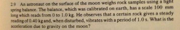

Printed textbook problem 2.9: an astronaut on the Moon weighs rock samples with a light spring balance, reading 0 to 1.0 kg over 100 mm, and a rock gives a steady 0.40 kg reading and vibrates with a 1.0 s period; find the Moon's gravitational acceleration.

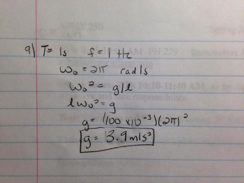

Handwritten pendulum calculation on lined paper: T = 1 s, f = 1 Hz, ω0 = 2π rad/s, ω0² = g/l, so g = (100 x 10^-3)(2π)², boxed result g = 3.9 m/s².
[/B]
Looks like your using the period for pendulum of length L instead of a harmonic oscillator of spring constant k
Also, you did not use the steady reading of 0.40 kg. This reading is related to the spring constant. (How?)
