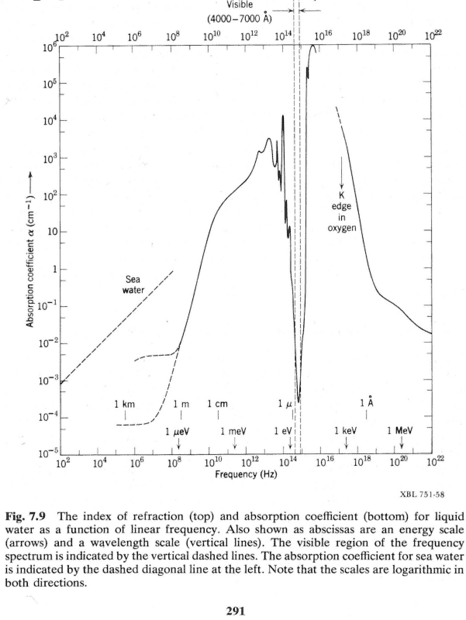

How does visible light penetrate seawater, when even a 1 MHz signal struggles? The question comes from studying how submarines communicate.
In conductive media like seawater, EM waves experience attenuation related to their frequency. The skin depth formula calculates the depth at which ##e^{-1}## attenuation is reached. The skin depth is inversely proportional to frequency.
In practical terms, only extremely low frequencies (eg 80 Hz) are able to penetrate significant distances, and the range of even a 1 MHz signal would be a metre or two.
So how is it that blue light, an EM wave around ##10^{14}## Hz is feasible for submarine comms, or to put it another way, given the above, why am I able to see things when swimming in the sea?

With that trend, a ##10^{14}## Hz blue light wave should have no chance, so there’s something I’m missing. If I’ve read your last sentence correctly, @.Scott , are you saying that at visible light frequencies, a different effect comes into play that overcomes the attenuation?
The EM absorption of water varies strongly with frequency. There is a passband at visible frequencies (which is no doubt why animals, including humans, evolved eyes to detect this band). From J.D. Jackson, Classical Electrodynamics, 2nd ed.:
Log-log plot of absorption coefficient (cm^-1) against frequency (Hz) for liquid water, with energy and wavelength scales marked; a dip near the visible band, a sea water dashed curve at the left, and a K edge in oxygen.
Only in simple conductors with constant resistivity.
Which is soooo far away from blue light as to be irrelevant.
Don't confuse what you read in an EM textbook with chemistry. Metals are special because of the (relatively) free conduction band electrons; that's not like sea water.
The term spectroscopy comes to mind...

This seems to explain it - thanks. Another example of how the fascinating behaviour of water has enabled and shaped life.
