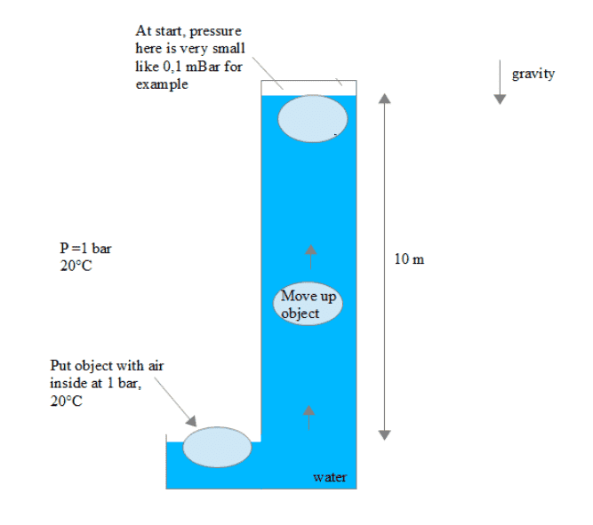

The drawing show a barometer with water inside. If I move up object with air inside I recover PV energy (P=external pressure, V=volume of object). If I want to move out object when it is at top, I need PV, is that ?

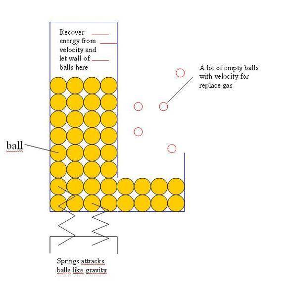

So if it's that. If I replace:
1/ gravity by balls attracted with springs (for have law of gravity in blue column)
2/ atoms with empty balls with very thin walls
3/ pressure with velocity of empty balls
4/ object to move up with some empty balls
I can disappear empty balls at top: at top we can recover energy from velocity and let at top only the small walls of balls. If walls are very very thin, I let virtually nothing. With friction = 0 where the energy is lost ?

It takes energy to force the object into the bottom of the tube against 10m head of water (about 1 bar).

The work required to push a ball into the bottom of the tube by any method requires that work be done against the pressure difference between inside and outside. This is (at least) as large as the work the ball does in rising to the top of the tube.

but it's like a barometer not a simple column of water, no need energy to enter in water because outside pressure = 1 bar.
That just means the problem is elsewhere. If the thing is 10m high the pressure at the top will be close to a vacuum so work has to be done on the object to get it out to atmospheric pressure.
Personally I don't find it productive looking for reasons why a perpetual motion machine won't work.
I'm agree with that, the sum of energy is 0.
But I would like to know with a macroscopic scale system. Imagine the system with balls, velocity, springs, ..., like that it's possible to recover energy from velocity. And if balls are empty, they disappear at top, let only walls and walls can be very small in theory.
I put a drawing for show an example. Sure the system would be complex but it's only a technological problem.

I'm not sure what you are trying to achieve? It's easy to make a system that appears to have a cycle over which the energy sums to zero. Here are three examples..
1) Planets orbiting the sun. PE and KE exchanged in eliptical orbits.
2) Magnetic spring..Imagine three magnets arranged...
NS SN NS
with the outer pair fixed to the desk and the middle one free to slide left and right. If you pull it to the left and let go it will oscillate back and forth.
3) Imagine a mass on a spring. If you press the mass down energy is stored in the spring. Let it go and that stored energy is converted to PE. The mass bounces up and down.
In an ideal world the these systems keep going forever because the energy sums to zero. How well they work in practice is also "only a technological problem".
There is no excess energy to be harvested from the velocity the objects have in your system. That energy will have come from somewhere.
After awhile most people stop playing noughts and crosses (aka Tic Tac Toe) because they realize you can only ever draw no matter how well you play.
