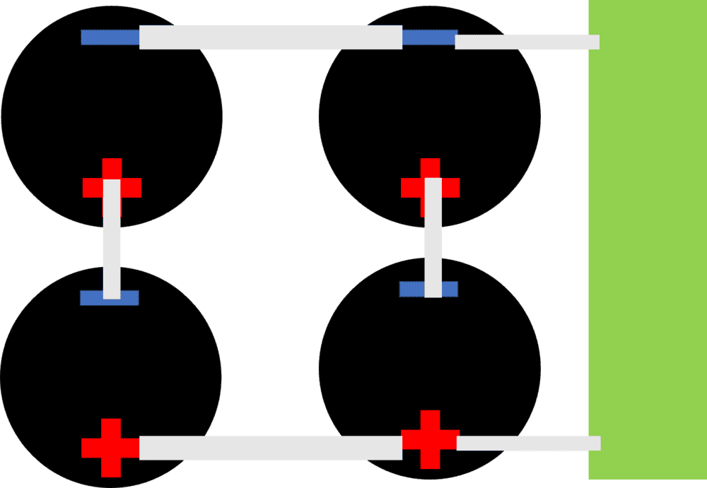

I'll make a power bank with capacitors and I made circuit of it. But I'm worrying about whether the circuit is safe, because it's dangerous to use capacitor.
So, can you check the circuit i made??
My capacitor is 2.7V, 600F and the power bank circuit has "Charging current : 1A maximum, output current : 2.1A(5V) maximum, ouput voltage : 5V DC","http://www.11st.co.kr/product/Selle...%DB_PC_S_%BC%EE%C7%CE&utm_medium=%B0%CB%BB%F6"
I wonder if you understand this site because it's korean :(
Thanks. :)
Web site in Korean is useless here and I have no idea what it is that you think is unsafe. You seem to be working with very low voltage and very low current capability. What do you think is unsafe?

I thought whether the power bank circuit gives voltage to the capacitor that greater than 2.7V. Isn't it?
Well, yes, if you are using a capacitor that is rated too low for the voltage you are using that could make the capacitor have dialectic breakdown. Why would you do that?

I'm not familiar with placing large value supercaps in series, but for more normal size capacitors in series, we generally would put large resistance value resistors in parallel with each capacitor, to help to equalize the voltage on each. But with such large value capacitors (600F !), I'm not sure that technique works...
I clearly was not paying attention. Thought the caps were in parallel. @emtae55 you should be OK since each cap only gets 1/4th of the voltage, so about 1.25V per cap. Still, you should check equalization, as @berkeman pointed out.

If the translate got it right then this thing is for Li-Ion batteries. Current seems to be OK, but I'm not sure if it's for single or for double cell?
Quite wasteful to use that suparcap bank this way, but it's expected to be safe.
Though I would put a small fuse in series somewhere.
Ps.: wait, your circuit is actually four supercap in series :woot: Are you sure about that? It's safe up to 10.8V or so, but ... erm...

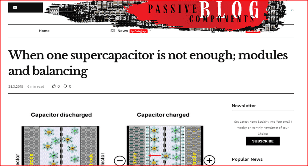

Passive balancing technique with resistors or ZDs is widely used and protection circuits are similar to circuits for series connection of Li-ion batteries . A colleague has written a paper with simuls included:
https://bib.irb.hr/datoteka/942041....balancing_using_resistors_T.Bari_pp_15-22.pdf

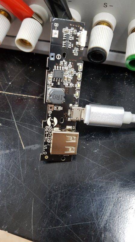

Um, guys, I tried to make a batteries, but it doesn't work. I used DMM but it displayed 0V when i measured the charging part.(The charging board's 'B+' and 'B-') I think it is because of the board, so i want to find another one.
The board's name is '864-KC v1.0'. Google it! and the circuit was like this. Thanks
Any half-decent Li-charger board would need a bunch of different kind of protection circuits: likely against charging non-healthy (under-depleted, 0V) cells too.
I think you have to supply the initial charge of supercaps yourself, before the charger can kick in.

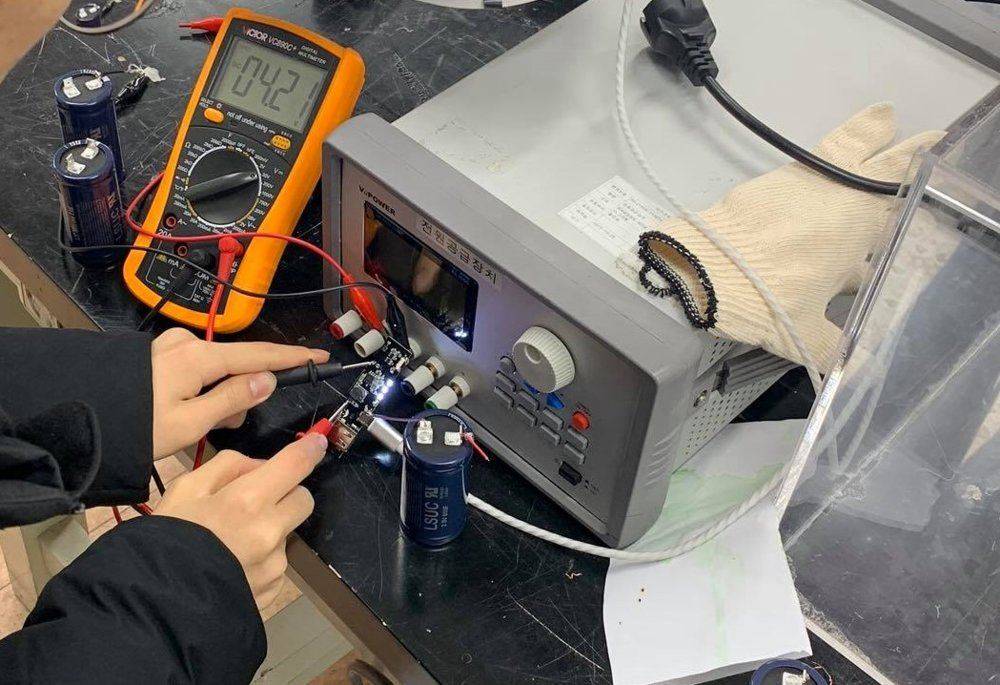

I tried it, but it didn't work. I charged the caps and tried to charge with the board, but i couldn't charge them

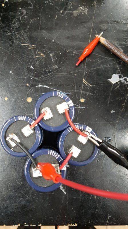

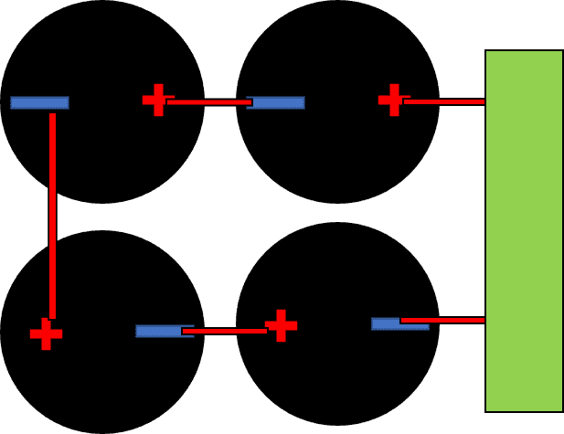

I'm in a project that make a powerbank with supercapacitor. I made it but it didn't work. Can you confirm it?? My circuit is here. The green one is a board (charging board, 864-kc v1.0). It gives 4.2V DC to capacitor.

So far, seems the circuit would work without balancing resistors. Super-capacitors typically have quite uniform Rseries and capacitance to connect them in series without balancing. Take care to equalize temperatures though (make a solid common heat sink) .

The photo you show is for a USB power supply that will turn off if more than 1A output is needed (some will work to 2A).
Put a resistor in series with the power supply output for charging. A resistor value of 5 Ohms or more will limit the current to less than 1A. The power rating of the resistor must be 7 Watts or higher, otherwise it will get too hot and burn up.
If the power supply will really supply 2A, then the resistor can be 2.5 Ohms and 15 Watts or higher.
With a 5 Ohm resistor, it will take about 1 Hour to charge the capacitors to 2/3 of full. A full charge will take about 5 Hours. If you want a faster charge you will have to use a higher current supply and a lower value (or no) resistor. To charge in 10 minutes needs a 30A supply. These numbers are not exact but are probably within a factor of 2. (that means it might take twice as long or half as long)
