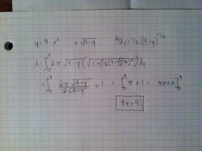

The curve is y=9-x^2, between 0 < y < 9 and you are rotating about the y axis.
It looks like you have applied a formula instead of understanding it.
That leads to uncertainty about the answer.
i.e. could you find the area dA of the strip on the surface between y and y+dy?
Lastly: you have not asked a question - do you have an issue with what you have done?
This information helps us to direct replies to where you need them.

Sorry, my first question would be, is it correct?
If not could you point out the beginning of my mistake.

I can't really tell without doing it myself - it looks like the right formula.
dx/dy is incorrect, but not in a way that will affect the result.
You should also double-check your algebra in simplifying the integrand.
$$\sqrt{9-y}\cdot \sqrt{1+\left(\frac{1}{2}\frac{1}{\sqrt{9-y}}\right)^2}=\left[1+\frac{1}{4}\frac{1}{9-y}\right]^{1/2}\sqrt{9-y}=\cdots$$... how do you take the √(9-y) inside the other square root?

Okay, I made another attempt at this problem but once I start to take the integral things become very ugly.
This is where I am now. http://www.wolframalpha.com/share/clip?f=d41d8cd98f00b204e9800998ecf8427e51gddpbmno
If someone could tell me if I'm on the right track and if so which way is the best to integrate and if not then I think I need help setting up the problem. I will be active for the next few hours so we can facilitate the discussion.

I do apologize. I guess I'm not confident in putting math into words.
I'm trying to follow formulas for similar problems.
I rewrote the problem in terms of x which gave me x=sqrt(9-y)
took the derivative which gave (-1/2)(9-y)^(-1/2)
therefore S=∫2∏x ds
with ds=sqrt(1+(1/4(9-y)))
The next step I have is S= 2pi * integral of ((9-y)^(1/2)*(sqrt(1+(1)/(4(9-y))) from there the integral turns really ugly for me so I'm assuming I've made a mistake somewhere
therefore S=∫2∏x ds

Can anyone spot a/the mistake?

Use a common denominator inside the radical sqrt(1+(1)/(4(9-y)), then combine the two radical expressions into one radical expression.m0gh said:I do apologize. I guess I'm not confident in putting math into words.

... it is better to use maths ;)I'm trying to follow formulas for similar problems.
$$x=\sqrt{9-y}$$I rewrote the problem in terms of x which gave me x=sqrt(9-y)
Reasoning: the distance of the surface from the y-axis is x(y).
Reasoning: the area of the annulus (the surface ring) between y and y+dy is dS=2\pi x ds where ds is the length, along the surface, between x(y) and x(y+dy).took the derivative which gave (-1/2)(9-y)^(-1/2)
therefore S=∫2∏x ds
with ds=sqrt(1+(1/(4(9-y))))
The total surface area is the sum of all the annuli: $$S=2\pi\int_{S}x\; ds$$
... in this case: ##ds = \sqrt{1+(dx/dy)^2}\; dy##, so you need to differentiate x(y). $$\left(\frac{dx}{dy}\right)^2 = \frac{1}{4}\frac{1}{9-y}$$
$$ S=2\pi\int_0^9 (9-y)^{^{\frac{1}{2}}}\left(1+\frac{1}{4(9-y)}\right)^{\!\!\frac{1}{2}}\;dy$$The next step I have is S= 2pi * integral of ((9-y)^(1/2)*(sqrt(1+(1)/(4(9-y)))
... Ugly integrals are normal in real life, though less common in school problems. You've done tricky integrations before, the way forward is to look for a way to simplify it. SammyS suggests:... from there the integral turns really ugly for me so I'm assuming I've made a mistake somewhere
... a "radical expression" is anything with a square-root symbol.SammyS said:Use a common denominator inside the radical sqrt(1+(1)/(4(9-y)), then combine the two radical expressions into one radical expression.
You also got a nudge in that direction in post #4.
... you should know several techniques for integrating square-root functions.... how do you take the √(9-y) inside the other square root?

Thanks everyone for your help with this one. I talked with my professor last night and her first question was why I set it up as x = \sqrt{9-y} She told me to try it again the way it is already set up.
Honestly I did it the first way because it was my intuition and I didn't question it.
Here is the solution I got after she made that suggestion.
y = 9 - x^2
Taking the derivative:
f(x)' = -2x
Squaring the derivative gives: 4x^2 (for future use)
Set up the Surface Area equation as:
2pi \int_0^3 x \sqrt{1 + f(x)'^2}\ dx
Take integral with u-substitution:
Let u = 1 + 4x^2 then du = 8x
which gives: ∏/4 \int_0^3 u^{(1/2)} \ du
Integrate: ∏/4 [{(2/3)} u ^{(3/2)}] = ∏/4 [{(2/3)}(1+4x^2)^{(3/2)}] evaluated from [0,3]
Sub in the values: ∏/4[{(2/3)}(37)^{(3/2)}] = 117.84
This is my first attempt at using the Latex code so please forgive me as parts of it still do not look right. Regardless this is the correct answer. ( At least, according to my professor )
y = 9 - x^2
f(x)' = -2x

For the math - you still sound like you don't really understand what is going on...
It is much better to understand than to memorize equations.
The surface of a solid of revolution has a rotation axis (in this case the y axis) and it has a radius that varies with position along the rotation axis.
Your method starts by working out the area of the annulus between y and y+dy, which, I agree, is more intuitive. The prof's method is to find the area of the annulus between r and r+dr ... (in this case, r=x).
It is the advantage of using polar coordinates.
The equation of the surface is: y(r)=9-r^2
The annulus between r and r+dr has area ##dS=2\pi r \;dl## where ##dl## is the length along the surface between r and r+dr. So $$dl=\sqrt{dr^2 + (y(r+dr)-y(r))^2}\\ \qquad = \sqrt{1+\left(\frac{y(r+dr)-y(r)}{dr}\right)^2}\;dr$$... notice that the remaining squared term inside the radical is the definition of dy/dr ?
Then you get the formula you used above.
In terms of memorized formula - the surface area of a solid of rotaton is: $$S=2\pi\int r\sqrt{dz^2+dr^2}=2\pi\int_z r\sqrt{1+\left(\frac{dr}{dz}\right)^2}\; dz=2\pi\int_r r\sqrt{1+\left(\frac{dz}{dr}\right)^2}\;dr$$ ... where the z-axis is chosen to correspond to the rotation axis, and ##r^2=x^2+y^2## is the distance from z to the surface.
