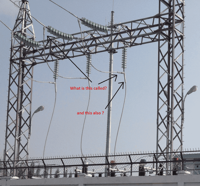

Dear friends
I need the names of these components show in attached pictures of Switchyards. So that I will get information form google and there manufacturer.
Picture 1
Picture 2
Picture 3
I think the usual term is "substation". Check out http://new.abb.com/substations.
From a more engineering point of view: in general those pieces of equipment are called clamps. That would be the case of pictures #1 and #3, where the bus is connected to a dropper (downward cable). When there is an angle connection where there may be electrodinamic or mechanical forces , as in #2, they are called strain clamps.

thanks buddy your the life saver to me...
