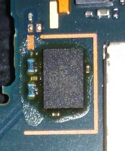

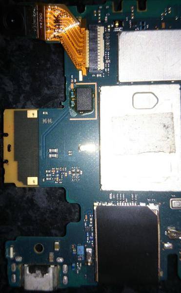

Thanks for the reply, I took a photo of the part that looks damaged. Do you suspect this part is the protective diode matrix that you talked about? I can't seem to find any other abnormalities on the board other than this. Could the phone still work if I replace the port or externally charge the battery?
Thanks.

If the second image bottom left corner is the USB connector, then please make a photo about that area, from both side of the PCB.

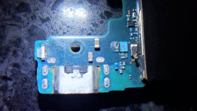

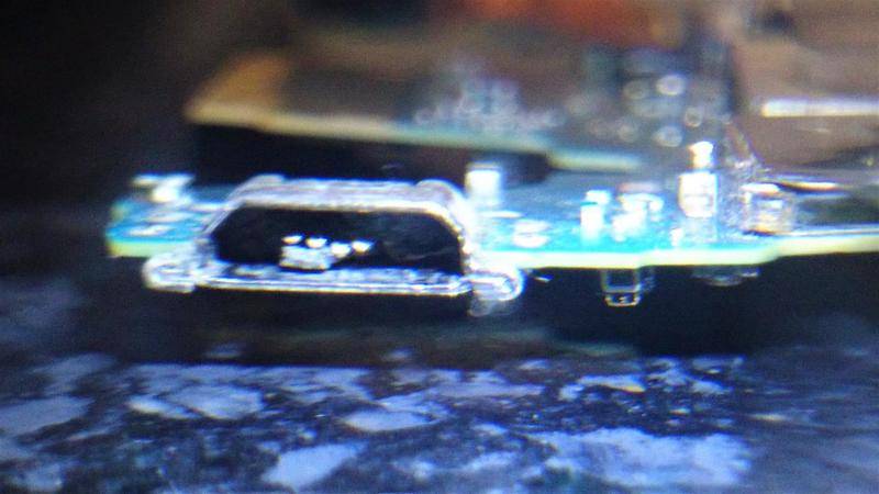

Okay, I took three photos of the area. Including the broken Micro USB Port. :wink:

On the second picture those four darker components, especially that square one near the connector. Those are the protective diodes. Most likely, at least.
I can see nothing, but that means exactly: nothing.
