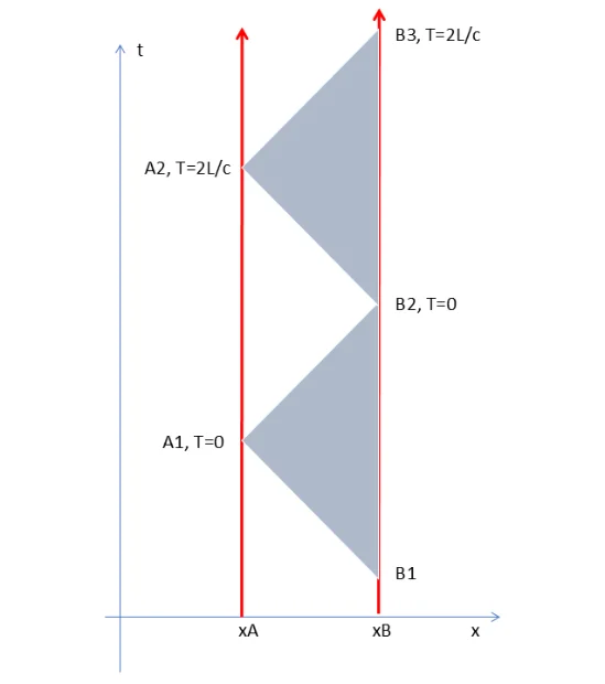

Just to clarify the point, I drew the following diagram. The base grid ##(x,t)## represents of course the standard inertial coordinate system, in gray the relevant light cones.
At event B1, observer B sends a light signal to observer A. A receives it at A1, resets its own clock to read T=0 and sends back the signal to B encoding T=0 within it. B, upon receiving it, resets its own clock to read T=0 as well. From now on their clocks are synchronized and basically define the coordinate time T (uppercase T).
Using this procedure, since observer A and B are rest each other -- as they can ascertain by using round-trip travel time as measured by their own clocks -- the 2WSOL is ##c## (since the light round-trip-time is ##2L/c## for each of them), however what is the OWSOL ?
In A -> B direction OWSOL is infinite while in B -> A direction is ##c/2##. Indeed in the latter case B sent at B2 a light signal when the coordinate time was T=0 which reaches observer A when its (now synchronized) clock reads the coordinate time ##T = 2L/c## (event A2). By dividing we get $$ \frac {L} {2L/c} = c/2$$

I agree this works, but only because you have defined the convention for the 1-way speed of light in both directions.
Yes exactly. For instance this convention does prescribe to reset to 0 the B's clock at event B2 (i.e. label it as T=0 along B's worldline) when B receives back the light signal emitted at event A1 that encodes T=0 within it. Thus this procedure/convention defines OWSOL as infinite in A -> B direction.
