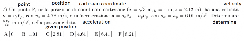

Hello.
Sorry for this very silly question, but I struggled myself too long on this (it was on the test and fortunataly I could answer correctly, but have not understood how to solve that).
I know a particle, in a certain instant, has position ##(x_0,y_0,z_0)##
I know the velocity magnitude ##\vec{v} = v_p \hat{\tau}##
where tau is the tangent unit vector.
And I know also the acceleration vector:
##\vec{a}=a_0\hat{x}+a_0\hat{y}##I have to find the tangential and centripetal acceleration of the particle at that instant.Thanks.
tangential acc is a times tau.
you can then figure out centripetal acceleration.
Ok, I think I should insert the numbers here, because I have to figure out the numerical value and I do know nothing about tau.
position ##(x_0 = \sqrt 3 m , y_0=1 m , z_0 =2.12 m)##
##v_p = 4.78 m/s##
##a_0 = 6.01 m/s^2##
I have only this, nothing less, nothing more.
Please, it's my last unfinished business.
This is the original text. It's in italian, but mathematics is a universal language.
Italian multiple-choice physics problem 7 with a point P at Cartesian coordinates (x = √3 m, y = 1 m, z = 2.12 m), velocity v = v_ρ ê_ρ with v_ρ = 4.78 m/s, and acceleration a = a_x ê_x + a_y ê_y with a_x = a_y = 6.01 m/s². Asks for dv_ρ/dt in m/s² at the given position. Options: A 0, B 1.01, C 2.81, D 4.61, E 6.41, F 8.21.
ep = cos30 ex + sin30 ey
then take the dot product of ep and a
i.e.
(cos30 ex + sin30 ey)⋅(6.01 ex + 6.01 ey)
