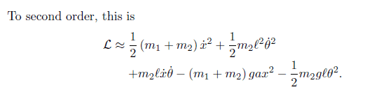

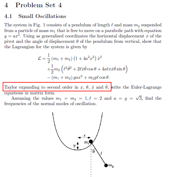

Given that x and x2 in the Lagrangian don't need expanding, I simply took the Sin and Cos parts up to their x2 terms and replaced them accordingly in the Lagrangian. However the given solution (below) seems to have done things rather differently. In particular I notice the 4a2x2 term and the Sin term have both become zero.
Can anyone explain why this is? Some obvious algebra error on my part, or a fundamental aspect of Taylor expansions that I haven't properly grasped? Many thanks.
Well, the term proportional to [itex]x \dot{x} \dot{\theta} sin(\theta)[/itex] is 4th order (treating [itex]x[/itex] and [itex]\theta[/itex] as the same order).
Ahhh, so yes it was a fundamental error in understanding on my part.
Back to basics for me...
