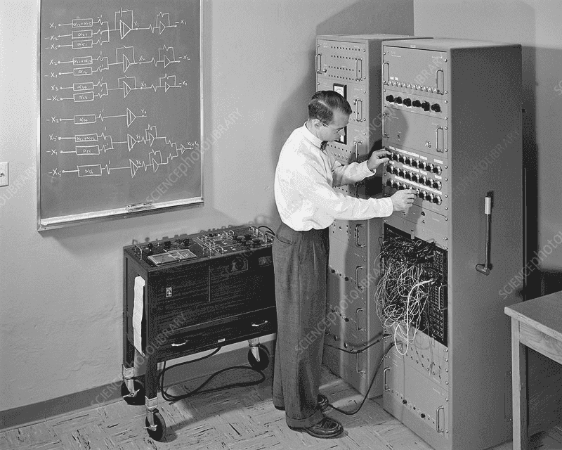

I enjoyed exploring nooks and crannies around NASA Ames while taking breaks from arduous programming tasks. I found long banks of once state-of-the-art computers below 'my' then-new VAX computers installed in the Unitary Plan wind tunnels control room. The resident data tech called them "Beckmans" and showed me (literal) bins containing curls of paper tape punched with hex data from the last run.
I learned they were programmed by changing wiring, sometimes involving soldering components between missions to achieve optimum results. Luckily, we installed RS-232 interfaces on the VAX's for multiple terminals as I am probably the worst solderer ever permitted to manage complex electronics. :cool:
Modern Beckman has morphed into Life Science fields.

LOL, with that handle on side looks like some early one-armed bandit :wink:

That is so cool. thanks for posting this pic. This stuff is so cool. i wish it was taught more in classes.

That 'Handle' would be the latch that holds in/ejects the plug-board (patch-panel).
That rats nest of wires on the front in the plug-board is the programming for that analog computer.
The knobs the operator is twiddling are 10-turn potentiometers (Helipots) that set the gain for the amplifier stages. In the mid 1960's the pots were 0.1% linearity for about $60 - $80 each. The amplifiers (vacuum tube Op-Amps most likely) can be connected as amplifiers, integrators, differentiators, or just buffers between stages. Fixed Multipliers and dividers in the equations are handled by setting the pots and accounting for scaling.
Multiplying and Dividing by variables was with more complex and dedicated stages, often with one variable driving a motor that turned a pot affecting the gain of the other variable. Not quit as simple to use as the DIV instruction of the computer you are reading this on! Those stages usually required more maintenance too.
The roll around cart below the chalk board is a Strip Chart Recorder used to graph the output of calculations.
Unfortunately the original photo was stored as a .jpg file at one point in its life; thus there is not enough info retained to enhance and read the make/model of the computer.

Thanks @Tom.G for the detailed descriptions. The Beckmans I encountered, stored in an operational configuration in case they were needed, were operated through the 1970's. I found the 1960's era photo online. I like the circuit diagrams on the blackboard and the programmer's period clothing.
The programmer has 'dressed down' according to the strict dress codes of that era; rather like Woz wearing a Who concert T-shirt or skinny Steve Jobs dressed in a black turtleneck and Gap pants. Casual.
