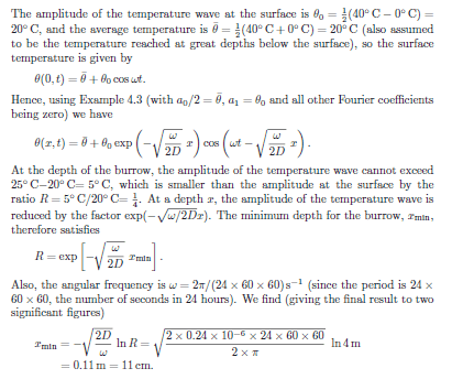

Confusing myself, here is an example I have been looking at
First, the equation in the OP isn't quite right. It should be ##\theta(x, t) = ...##, as shown in the later post. Pick some depth x. What is the minimum temperature that it can be at that depth?
