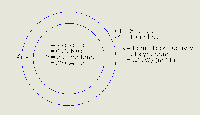

Thanks for the reply sir chestermiller :)
now i got my initial equilibrium temperature, it is also illustrated below.
t1 = ice temperature = 0 Celsius
t3 = outside temperature or room temperature = 32 Celsius
d1 = inner diameter of the container = 8 inches
d2 = outside diameter of the container = 10 inches
k = thermal conductivity of styrofoam = .033 W/m*K <-- based on engineeringtoolbox.com
My current status as of today is i finished calculating the heat loss in KJ/hr. Is there a way to change KiloJoule to Celsius?
Did you assume that the solid block of ice completely fills the chamber in the initial state? By assuming that all the material inside the container is well-mixed, you are obtaining a lower bound to the amount of time needed to raise the temperature. This will give you the minimum time needed to achieve a given temperature. This assumption transforms the problem at hand into a Newton cooling problem. To get the temperature as a function of the amount of heat added, you need to recognize that first that the contents stays at 0 C until all the ice melts and then the temperature rises. You need to work with the latent heat of melting and the heat capacity of liquid water (the latter once all the ice has melted).

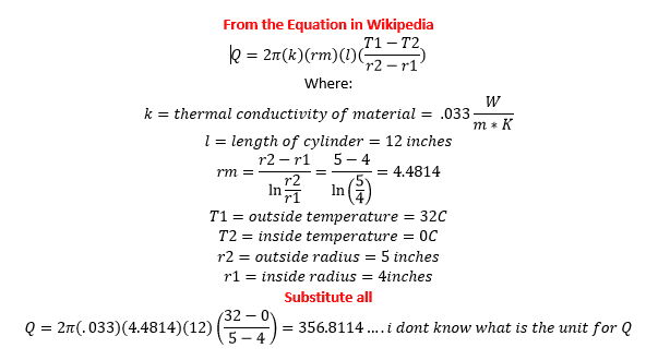

I would like to ask this about Newton's law of cooling. Does the equation factor the thermal conductivity of the material and its thickness or do i neglect it? sorry again for this simple question as i don't have any other reference to this subject matter T_T
Update: I recently read the article from wikipedia, is this the correct answer for my question sir?
https://en.wikipedia.org/wiki/Thermal_conduction#Cylindrical_shells
After this, I seem to have gotten Q though i don't know what is the exact standard unit. How will i convert this to temp per unit time?

derekgabs said:
Thanks again for replying to me sir, though I am sorry for the late reply.
It neglects it. As I said, the analysis only bounds the answer. If you want to include heat conduction in the material and its thickness, the model becomes significantly more complicated (but doable).
This analysis would not handle the transient heat transfer analysis within the material inside the container.
Sorry if I am a bit pushy on the questions T_T
Show us what you did.
I think i did my calculations wrong again T_T
Below is the snap of my calculation.
