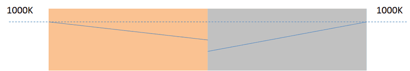

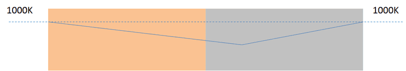

Left side is copper bar and right side is steel. Neglecting the effect of thermal contact reisistance; If you consider this then diagram should be like below;
Above diagram is not an equilibrium diagram; equilibrium diagram would be simply horizontal line of 1000K.
As thermal conductivity of both the bars are different that means slope of temperature profile would be different inside bars.
Please correct me if I am wrong, #Mentors
Assuming a radially insulated bar - no heat flow in the y or z direction - heat flow only along the x-axis.
Assuming heat conduction of copper > heat conduction of steel.
assuming heat capacity of copper is < heat capacity of steel.
You do not give any time frame for your diagrams.
Nor a pick for the starting temperature of the bar(s).
If we take the top diagram, and have the initial temperature, T0, of the bar(s) at time t0.
If we assume T0 at the bottom of the graph, then the temperature profile is what it would be 3/4 ( approxiametely, could be 7/8, but more than half way through to equilibrium ) of the time it would take the bar(s) to reach 1000 C throughout.
And NOT at to when the bars have the 1000 C applied to their ends.
The line from the left to the right, should have one slope for the copper, and a different slope for the steel, as the thermal conductivity and the thermal diffusivity for each are not the same.
The one correct thing is that the two lines left to right, and right to left, I would agree, should meet at the same temperature somewhere in the steel.
The bottom graph should have the temperatures profiles from the left and from the right meeting somewhere also in the steel. What you have is the heat flow abruptly stopping at the copper-steel junction. Not sure why - Did you put for some reason a perfect insulator there? Or a good choice you made that the contact resistance >> conductivity resistance?
You should take note that there is such as thing as heat capacity as well as heat conduction. Both are properties of material. If we slice our hypothetical bar into sections, then before at any section of a material can conduct heat to the next section, it has to absorb heat. By absorbing heat, the temperature of the section will rise and only then can heat be sent along to the next section. Of course this does not happen in discrete steps but is a continious process, with the sections of width dx, and temperature between sections of dT.
At the start of applying the 1000 C, there is a large temperature difference from that to the first section, the slope dT/dx should be very steep. As time progresses, the slope should become more and more horizontal, until as you say, at equilibrium, the whole bar is at one temperature of 1000 C.
Having said that, at no time though, as time passes, is the temperature profile an exactly completely straight line from the 1000 C through to the sections of bar that have already been heated up to the particular section of the bar that is just beginning to heat up, ( at a lower dT/dx than precious sections ) , wherever that particular section be may be.

I think the main thing that @256bits is saying (please correct me if I am wrong) is that the heat conduction situation within the bar might be transient, meaning that the temperature is changing as a function of time. If this is the case then, no matter what the initial temperature profile within the bar was, at all times greater than time zero, the temperature profile will be continuous. And the required boundary condition at the interface between the two materials will be that the heat flux is continuous across the interface. So, the two temperatures match at the interface, and the two heat fluxes will match at the interface.

Yes , a condensed summary, of a transient heat flow.I think one have an incorrect statement, ( uneditable ).
It should read,
If we assume T0 at the bottom of the graph, then the temperature profile is what it would be 1/4 ( approximately, could be 1/8, but less than half way through to equilibrium ) of the time it would take the bar(s) to reach 1000 C throughout.

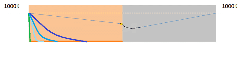

What do you mean by 3/4 and 7/8 here?
I have drawn different slopes for them; as diameter of bars are small, it appears to be same almost. but as length is same for both the bars and they are not meeting at centre, that means they have different slopes.

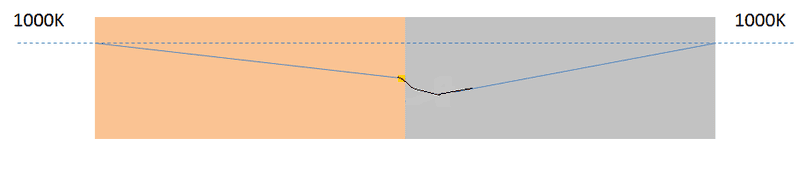

I admit that I made a mistake; it should not be abrupt. It should be like below

See the edit I did .I admit it is not a particularly well formed statement, and neither is the edit.
As you know, difference in temperature drives the heat flow.
As the temperature of the bar(s) increases, generally speaking the dT/dx becomes increasingly smaller. Thus as time goes by less and less heat flows into the bar(s).
The time for the left and right heat flows to meet at a halfway temperature between initial temperature and the final temperature ( 1000 C ) is less than the time to go from that halfway temperature to the final temperature.
Not necessarily a mistake. If the bars are loosely thermally connected, your graph could very well be more correct than not.
You drew a little curve there which is how it should look. Note that the lines from the ends of the bars which appear to be straight, also have some curve, barely noticeable due to the, as you say, the scale of the graph from the thinness of the bars.
Your transient temperature profile should look something like this, as time goes by,
I have shown only the copper side.
Orange - initial temperature of the bar.
Green - an instant after the 1000 C is applied
Light Blue - At some time t1
Mid Blue- at some time t2
Blue - at some time t3
I think OP has got his answer. He should verify it.
