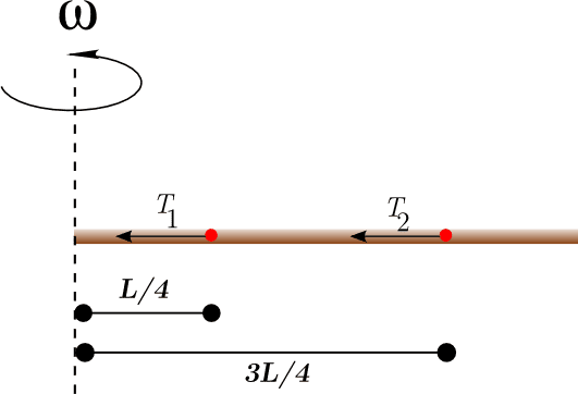

A rod of length ##L## is pivoted at one end and is rotated with a uniform angular velocity in a horizontal plane. Let ##T_1## and ##T_2## be the tensions at the points ##\frac{L}{4}## and ##\frac{3L}{4}## (respectively) away from the pivoted ends. Compare the magnitudes of ##T_1## and ##T_2##.
Centripetal force needed to keep a particle of ##m## moving in a circle of radius ##r## with angular velocity ##\omega##: ##\;\;\mathbf{F_C = m\omega^2r}##.
(The answer given in the text says ##\boxed{T_1\; >\; T_2}## but, as I show below, I think it's just the opposite).
I begin by putting an image relevant to the problem above. Taking a small particle each of the same mass ##m## at the two positions, the centripetal forces are ##T_1 = \frac{m\omega^2 L}{4}## and ##T_2 = \frac{3m\omega^2 L}{4}##.
Clearly, from above, we have ##T_2 > T_1##, contrary to the answer given in the book.

You got your masses swapped. The mass to the right of points 1 and 2 is what counts. At 3L/4 there is less mass being accelerated by the tension.

The tension at the point ##L/4## is not simply rotating a point mass there. It's providing the force to rotate the rest of the bar, all the way out to ##L##.
It is not a single particle at each location that is relevant. It is the body extending from the point in question to the outer free end that needs to be considered. Draw a FBD for the outer end of the rod from a point of interest to the outboard end. Then sum forces on that FBD and that will get the answer you were shown.
