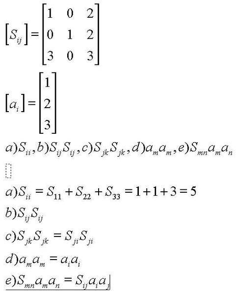

1. The problem statement and attempt at solution
Given the matrix S_ij and a_i evaluate a),b),c),d) and e)
For a) I think i use Einsteins convention.
b) I just first sum on i, and then on j giving me 9 terms. The answer I get is 24.
d) can i change m with i since they are both dummy indexes?
e) the same problem as d I guess, is this allowed?
I'm trying to learn continuum mechanics by my self, and this is the first step.
Thank you.
Yes, that is the sum of numbers on the main diagonal, also called the "trace".
?? I get 28, the sum of the squares of all terms. And, of course, (c) is exactly the same as (b).
Yes, but why would you want to? In any case this is the sum of the squares of the elements of a, 1+ 4+ 9.
No, this is not at all the same problem as (d)! (d) was amam which is, as I said, the sum of the squares of the elements of a: the same as the 'dot product' of a with itself. In particular, there is no "S" in (d). (e) is Smnaman. Multiply the "matrix" S with the column vector a, then take the dot product of that with a.
Thank you.[/QUOTE]
I didn't mean that e) was the same problem as d), I just wondered if I could change the indices from m to i and so on... You've answered that though, thank you very much!
