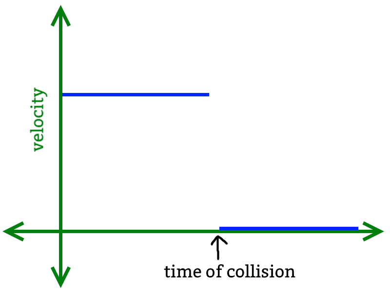

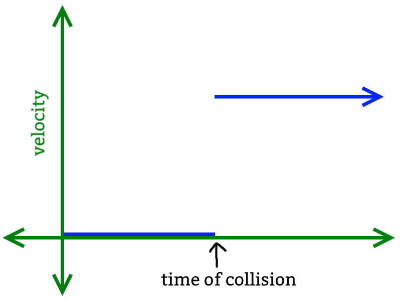

Something about collisions has been bothering me.
Let's say I have 2 particles with equal mass: one is moving at velocity v towards the other particle. Kinetic energy and momentum is conserved during this collision. However, I have a question: what is the acceleration of the particles during the collision? Is it infinite (since the particles suddenly change velocity in an instant)? I know it shouldn't be, or should it?
velocity-time graph of particle 1
velocity-time graph of particle 2
It depends on your model. As you've drawn it the velocities are discontinuous, so you are modelling their acceleration as instantaneous. This is not strictly realistic, but is a good enough idealisation for many circumstances.
In practice, objects deform during a collision and there is a smooth velocity change - albeit frequently on a timescale of milliseconds.

I know they will have the same magnitude of acceleration. I am more concerned whether acceleration is infinite or not because the change in velocity is instantaneous (although it has already been realized that it really isn't since collisions are basically interactions of electric fields of electrons repelling each other).

As you can see on the velocity-time graph, the velocity of both particles change at the time of collision. Since there is a change in velocity, there must be acceleration.

In the model @yrjosmiel is using, the force and acceleration are Dirac delta functions - that is they are infinite, but are applied for zero time. The integral with respect to time, however, is well defined, so the momentum change is finite. As I noted earlier this model is unrealistic, but good enough for many circumstances. If you are playing billiards, for example, you can model the balls as rigid and having instantaneous collisions with infinite accelerations because ignoring this is a much smaller error than others - e.g. in your accuracy with the cue (certainly with my skill level at billiards).
In practice, all objects deform slightly on a very short timescale, so the force is always finite and applied over a finite time. For example, if you are playing tennis you can impart spin to the ball by striking it with a racquet moving slightly sideways, and you'll get different effects depending on the tension in the strings. You can't neglect the deformation of the strings if you want to analyse that case.
Basically, the graph in post #1 is an idealisation. In practice, if you stretch the graph horizontally so you can see short enough times, you'll find that there is a very steeply sloped line joining the two apparently discontinuous segments.
