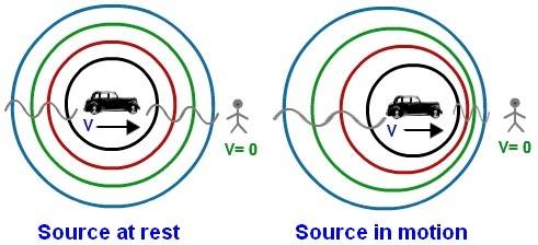

I was watching a video on the doppler effect by edx.org. The video said that the second wave of light given out, when the star(the light emitting object in this case) moves towards you, is not as big as the first one. So, it does not extend beyond the original wave. Why does this happen?
i mean when the source is in motion, why doesn't the black circle go beyond the red one, or the green circle beyond the blue one?
Because they propagate at the same speed.
Both waves are extending at the same rate and the inner one never catches up to the first because it was emitted later (just as my younger brother will never be as old as I am because he was born later and we age at the same rate.)
Oh. Thanks. But in the case of the car if the car were to accelerate, would it happen?
If the car accelerates to a speed that is smaller than the speed of sound, The inner spheres will shift even more but remain inside the outer spheres. If the car reaches speeds higher than the speed of sound the spheres start to overlap producing a sonic boom.
