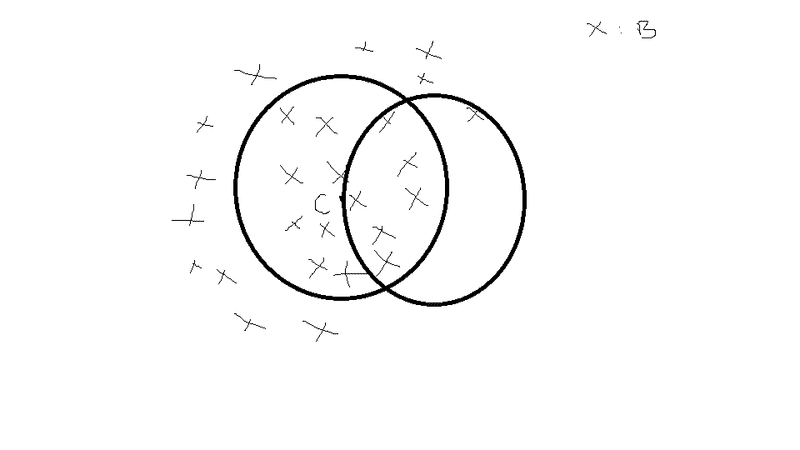

B is increasing with rate: dB/dt
when C is center of circle 1, Induced Electric Field is 0, but when i take another circle, in C, existing Induced Electric Field

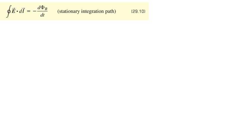

I used this equation to prove
Do Induced Electric Fields exist in C??

what i mean is: in C, Existing of Induced Electric Fields

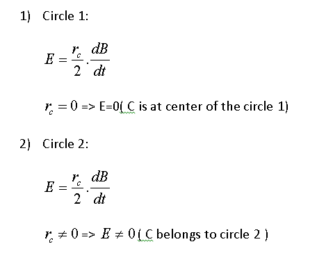

I have: E = (r/2).dB/dt( r is radius of circle 1)=> C doesn't have electric field
But when E' = (r'/2).dB/dt(r' is radius of circle 2) => C still have electric field( C belongs to circle2)
I think when B change, every where in space also have electric field, am i right
If r>0, and |dB/dt|>0 then E≠0 so why do you say this means that there is no electric field?

The calculation depends on where you put the center of the circle ...
But you've forgotten something - you are only calculating the contribution to the induced electric field due to the flux inside the circle.
In the first example you discovered that the flux at point C has no contribution to the field there.
In the second you found a non-zero contribution to the flux.
To get the total E field at C, you need to add the contributions from everywhere.

If the uniform magnetic field is confined to a circular region, then the induced E will be zero at the center, C, of the region. You should be able to convince yourself that there is no contradiction with applying the integral form of Faraday's law to any closed path. (Note that for a circular path not centered at C, then you will not be able to pull E out of the integral.)
If the uniform B field extends to infinity in all directions, then there is no unique answer to the induced E field distribution. So, it's not a well-defined problem.
A similar situation occurs if you imagine all of infinite space filled with a uniform charge density ρ and try to find the E field produced by ρ using Gauss' law. There will be an infinite number of different E field distributions that satisfy Gauss' law.
