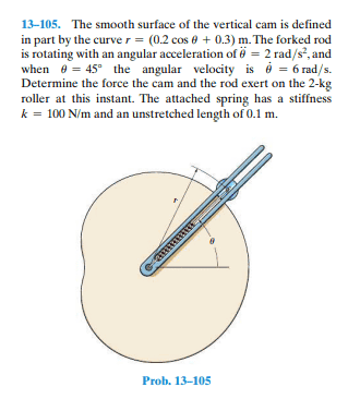

The smooth surface of the vertical cam is defined in part by the curve r = (a cosθ + b). The forked rod is rotating with an angular acceleration θ”, and at angle θ the angular velocity is θ’. Determine the force the cam and the rod exert on the roller of mass M at this instant. The attached spring has a stiffness k and an unstretched length l. Given: k = 100 N/m , θ = 45 deg l = 0.1 m , θ’ = 6 rad/s, M = 2 kg , θ” = { 2 rad/s
c ylindrical

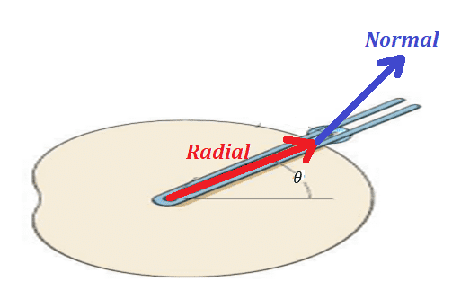

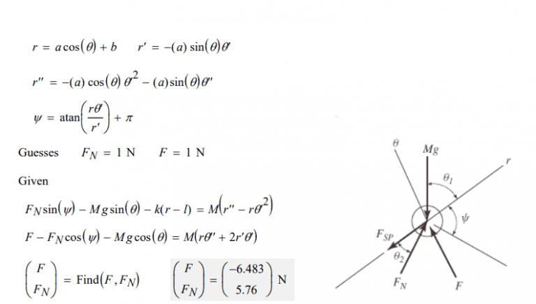

so this is what the FBD is.... but to be fair, to me this one looks as if the normal force in the direction of the radial line, yet it isn't????
here in the solution, it's not along the radial line, whys that???
The normal force is not in the direction of the radial line. Here I have distorted the shape of the cam into some other shape to emphasize things. In my distortion, the normal force is more vertical than the radial direction. For the shape given in the problem, the normal direction might be less vertical.
Maybe something I said in the last question mislead you. The normal force should be aligned with the cardioids center of curvature at that point. Thats not necessarily colinear with a radial line from the arms center of rotation to that point.

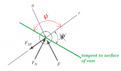

In the solution of post #1, ##\psi## is defined as $$\psi = \pi + \arctan\left(\frac{r \dot \theta}{\dot r}\right)$$ where I've used dots for time derivatives. Note that for this problem, the argument of the arctangent function is negative due to ##\dot r## being negative.
But, I don't think that the angle ##\psi## as shown in the diagram of the solution given in post #1 corresponds to this definition. Rather, if ##\psi## is defined by the equation above, then ##\psi## would be angle shown in red below
The equations for ##F## and ##F_N## in the solution of post #1 are correct for this red ##\psi##.
Note that the angle between the ##r## and ##\theta## directions should be a right angle, but it's not drawn very well in the diagram.

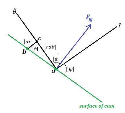

With this definition of ##\psi##, the absolute value of ##\psi## represents the angle shown below
You have to be careful with signs. For the shape of your cam, ##dr## is negative when ##d\theta## is positive. As the roller moves along the cam from point ##a## to point ##b##, you can construct the right triangle ##abc## with legs along the ##\hat r## and ##\hat \theta## directions. So, ##\tan |\psi| = \frac{|r d\theta|}{|dr|}##. You can express ##F_{N,r}## and ##F_{N, \theta}## in terms of ##F_N## and the trig functions ##\sin |\psi|## and ##\cos |\psi|##.
the problem here is that I get -72.23 degrees which is different from the angle calculated in the solution
I believe your value of ##\psi = -72.23##o is correct. The angle ##\psi## calculated in the solutions is a different angle than this. In the solutions, ##\psi## is defined as $$\psi = \pi + \arctan\left(\frac{r \dot \theta}{\dot r}\right) = \pi + \arctan\left(\frac{r d\theta}{dr}\right) =180^o
+ (-72.23^o) = 107.8 ^o$$ This is the red ##\psi## that is shown in the diagram of post #4.
