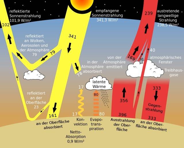

The energy goes back to the ground by absorption and re-emission (not reflection). There is a nice Sankey diagram in the German Wikipedia entry for the greenhouse effect:
[Edit: I just see that FactChecker posted an English version of the diagram in a parallel thread.]
