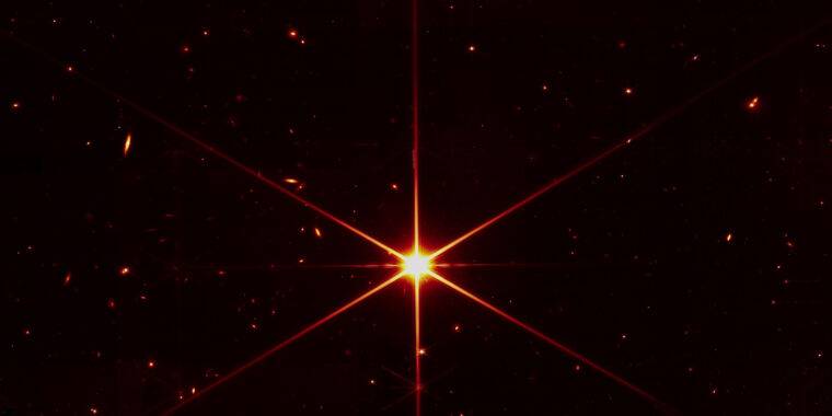

  • #429
pinball1970 said:
The six spike diffraction thing? @Andy Resnick @collinsmark with Webb?
Isn't that spike diffraction the standard thing with Webb, i.e. the same type of spikes that appear in photos of bright stars by Webb?
I don't know exactly why they appear (I guess it's either some "thingy" in front of the detector or maybe something due to the hexagonal mirrors, perhaps? (just a guess)). I remember seeing a video where they mentioned the spikes, but I don't think they specified in the video why the spikes appear.
  • #430
It's a diffraction effect from the mirror, with six-fold symmetry because of the hexagonal structure.

  • #433
It's the first big one I have seen since that initial calibration image. The star image with all the galaxies in the background that got all the astronomy community very excited.
  • #434
The six diffraction spikes are more caused by the three supports that support the secondary mirror. As said above, the Hubble has four secondary supports, so you get four diffraction spikes. The three Webb supports lead to six diffraction spikes, because you get one opposite to the support as well. I think the segmented mirrors also contribute to the diffraction spikes, but I think the secondary supports are the main cause.

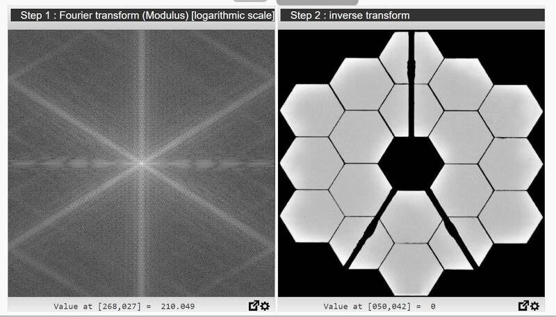

  • #435
Every detailed description I have seen says that the hexagonal mirrors are the larger contributor and if you just ballpark it there are more hexagon edges than support edges. Also there are not six spikes, it has eight. The fainter horizontal one is caused by the vertical support. The other two supports line up with the non horizontal hexagon edges.
Fun fact if you run the FFT algorithm on the NIR selfie image you get the spike pattern as a result.
  • #436
That isn't quite right.
If a telescope's secondary mirror was attached with a single rod/pole holding there would still be two diffraction spikes; each spike being perpendicular to the direction of the pole/rod/support.
In other words, consider a vertical pole that extends from the bottom of view to the center, where it holds the secondary mirror, the result would be two horizontal diffraction spikes: one in each direction. Now you can add another support, going from top to the center, without increasing the number of diffraction spikes, since the diffraction spikes from the two supports simply overlap.
The bulk of the diffraction spikes on the James Webb Space Telescope (JWST) come from the hexagonal pattern of the mirrors. Each mirror has 6 sides, and each side produces two diffraction spikes, one in each perpendicular direction. So there are really 12 spikes, but due to the symmetry of a hexagon there's overlap, so the end result is 6 observed spikes caused by the hexagonal shape.
Now we consider the 3 rods from the spider vanes holding the secondary in place. Two of those rods are aligned with the sides of hexagonal shape of mirror, so no new diffraction spikes are created by these rods (since they overlap with other spikes). That leaves the third rod that is not in line with any of the sides of the hexagonal shape of the mirrors. This rod leaves a new set of diffraction spikes -- and those additional two spikes are perpendicular to the rod.
So in the end, there's 8 diffraction spikes on JWST's optics: 6 prominent ones and 2 minor ones in the diffraction pattern.
[Edit: Technically, of the 8 diffraction spikes, there's 4 really prominent ones caused by both the hexagonal mirrors plus two of the secondary support rods, 2 somewhat prominent ones caused by the hexagonal mirrors without any secondary mirror support diffraction, and finally 2 subtle spikes caused by one of the support rods.]
It's worthwhile to note that this this diffraction pattern (which is wavelength dependent; I haven't discussed that here) doesn't just affect the resultant appearances of bright stars, but also the dim stuff too. Every light ray, every pixel in the image is affected by the convolution of the diffraction pattern across the entire image. Sure, the pattern is only obvious to bright stars due their higher contrast, but the diffraction pattern actually affects everything.
Edit: Conceptually, this is like trying to paint a picture on a canvas with the limitation that your brush is the shape of the diffraction pattern. It's not possible to place a dot on the canvas smaller than the brush/diffraction pattern; it's all or nothing. You can change the brightness, but not the size (for a given color). Also different colors will have slightly different sized brushes, thus slightly different sized diffraction patterns.
  • #437
  • Haha
  • #438
This makes a lot of sense, and is much more correct than what I wrote. Thanks for the detailed explanation.
  • #439
https://www.physicsforums.com/attachments/fft-jpg.325333/
The vertical support causes the 2 horizontal spikes and the edges of each mirror segment and the other 2 supports cause the other 6 spikes, so there’s a actually 8 spikes but the 6 spikes from the mirror edges and slanted supports are more prominent.
If you look closely at the 2 horizontal spikes, wave interference effects are prominent (the dark areas within each horizontal spike.) Thats from the light taking 2 different length paths to the image sensor from diffraction on either side of the vertical support causing destructive wave interference at some locations.

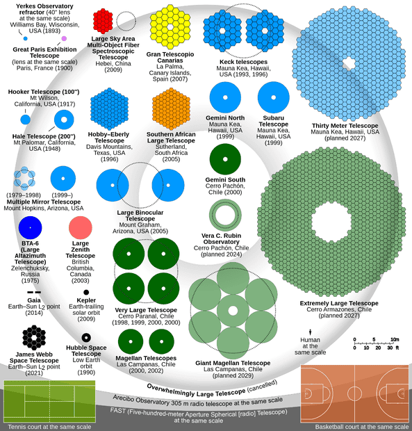

I was surprised to find out with such a big mirror the f ratio on the Webb is f/20.2. F ratio tells you how bright a point source will be on the sensor pixel at a given exposure time, with smaller numbers being brighter and generally “better” and more expensive, usually meaning a wider lens with more glass for the same field of view. A very nice camera lens is usually f/1.4 or f/2.8. Very expensive telescopes are usually f/4 to f/8 range. I have a sub $1000 (cheap) 2000mm focal length Maksutov Cassegrain reflector telescope and it’s roughly f/14.5… the James Webb is f/20.2! That means despite its huge mirror, a given point source will be much dimmer on a given pixel than an ordinary camera or telescope for the same exposure time. Interesting.
  • #441

  • #442
To Illustrate:
50mm focal f/1.4:
50mm focal f/16:

  • #444
The Vera C Rubin Observatory will be f/1.2. Keck is f/1.75. Hubble f/24. Giant Magellan Telescope will be f/8.
  • #445
Some of those things make Webb look small!
  • Haha
