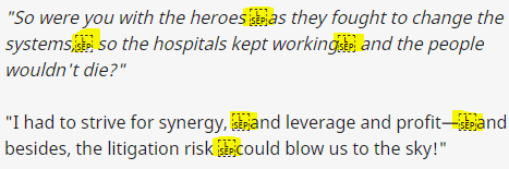

I wrote this doggerel in an attempt to capture the scorn I felt.
Song of the Year 2000
"What did you do in the Great War, Daddy? When the chips were down
 and fortunes made and lost?"
"I 'Re-engineered the Enterprise', with strategies, and leadership, and SAP and never mind the cost!"
"But what did you do when
 computers started saying
that the date was 1900
and the databases wrong?"
"I took a bear position
 as the markets started falling,
and acquired some assets going for a song."
"So were you with the heroes
as they fought to change the systems,
 so the hospitals kept working
 and the people wouldn't die?"
"I had to strive for synergy,
and leverage and profit—
and besides, the litigation risk
could blow us to the sky!"
"Then what were your priorities
when businesses were failing?
When the systems you had sold them, stopped
 and brought them to their knees?"
"I passed them to a partner skilled
in corporate recovery,
who asked for bank securities
to guarantee his fees."
"But Daddy, when the programmers were
 working nights and weekends,
 to find and fix the problems and
 to think out what to do, you were working there beside them, weren't you?
 Rescuing the clients? I have told my friends at school I know
 that you were fighting too!"
"My child, you must remember, I'm
a Management Consultant!
My time is too important to
 be spent on such affairs.
I leave such work to engineers —their time is less expensive.
 Now, clean your teeth and go to bed
—and mind you say your prayers!"
