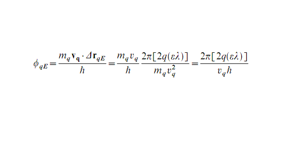

In the paper <Doer the Aharonov-Bohm effect exist? > by Boyer , he use a formula to calculate the phase subtraction.(The Equation (8) ) :
He first calculate the inluence from electrostatic force,then use the way of analogy to derive the situation of magnetic field.The Equation (8) is the former one. But if deduct it into the latter one directly , I have a question that what is the momentum of electron in the magnetic field ? Why in the Hamilton function we have the additional momentum (-eA) ,but general momentum is not relative to the potential of electronic field ? So the analogy is flawed . In Aharonov-Bohm effect ,the status of electronic one and of magnetic one are different.
