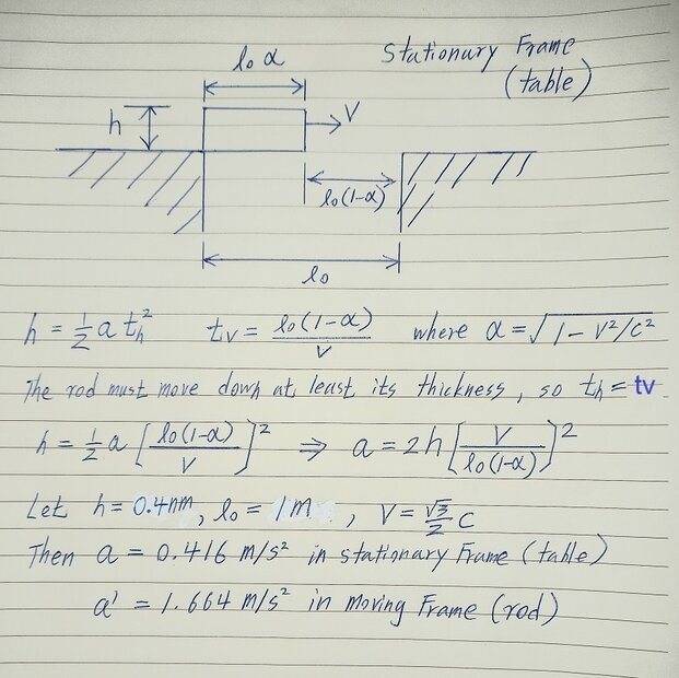

alan123hk said:
For thicknesses close to the atomic scale, there is still the strength of the gravitational field calculated in the figure.
In the figure you wrote:
figure said:
##\alpha = \sqrt{1-v^2/c^2}##
##a=2h[\frac{v}{l_0(1-\alpha)}]^2##
Let ##h=0.4nm, l_0=1m, v=\frac{\sqrt{3}}{2}c##
Then ##a=0.416 m/s^2##
Are you sure, that your numerical result for ##a## is correct?
According to my calculation ##a=2h[\frac{v}{l_0(1-\alpha)}]^2 = 6hc^2/(1m)^2##.
  • #152
Sagittarius A-Star said:
Are you sure, that your numerical result for a is correct?
You are correct. I 'm sorry that my calculation result is an extremely outrageous error.
By the way, I think that based on these calculation results, I have reason to believe that there may not be any substance in this world that can withstand the pressure generated by this so-called length contraction fallacy without being crushed, then some of the main components mentioned in this imaginative experiment, including the table that carries the sliding rod and the trap door of the hole, are almost impossible to exist.
  • #153
The rod is not being subjected to compressive forces when it is over the hole, it's being subjected to shear forces. It's not being crushed, it's being torn. The relevant parameter is not its resistance to static pressure but the sound speed inside the material--how quickly it can propagate changes in its internal forces in response to being torn. By hypothesis, since the "shear events", the events at which each horizontal point on the rod is subjected to an unbalanced downward force, are spacelike separated, it is impossible for the sound speed in the rod to be fast enough to compensate--it would have to be faster than the speed of light.
The table is only being subjected to pressure, and while the rod does move over the table, so the pressure at a given horizontal point on the table does vary, the resistance to pressure is entirely vertical and nothing needs to propagate horizontally. There is no shear on the table, and no spacelike separated events are involved in the table's resistance to compression.
Whether the removal of the trap door fast enough to not impede the free fall of the rod is possible given the parameters Rindler uses might be worth further investigation.
