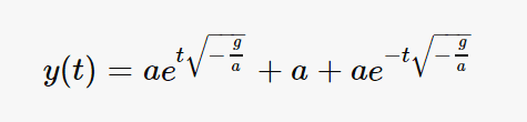

i tried to solve it using online calculator to save some time :
$$ y′′(t)+\frac{g}{a}y(t)=g , y(0)=3a , y′(0)=0 $$
the answer was ?! :
what am i doing wrong ?
patric44 said:
so you are suggesting that the differential equation would be :
$$ my''=mg-\frac{λ}{a}y ⇒y''=g-\frac{g}{a}y $$
is that the right differential equation to solve ?
the answer was ?! :
How else might you write eiy?
i could write this as :
after expressing this in euler's form and canceling the sin :
$$ y(t) = a+2\cos( {\sqrt{\frac{g}{a}}t}) $$
so
$$ t = \sqrt{\frac{a}{g}}\cos^{-1} ({\frac{y-a}{2}})$$
