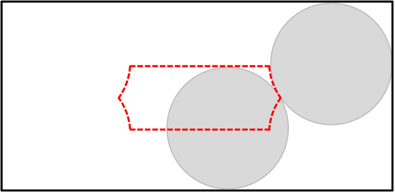

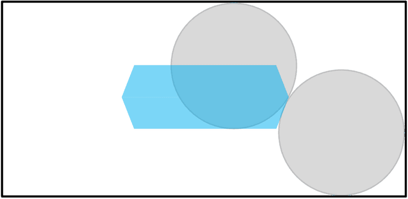

Let us consider a simpler and illustrative scenario.
Suppose that we have a rectangular area. Like an ideal air hockey table. We place a single ideal puck on this table. We launch the puck from one of the corners at a randomly chosen angle. We ask whether it will ever bounce back to its starting corner again.
For almost any launch angle we choose, the period for puck bounces between the short walls will not be a rational multiple of the period for puck bounces between the long walls. So there is no time after the start at which an exact integer number of round trips will have occurred for both directions simultaneously.
If the pucks are identical, we know that their CM at the time of puck-to-puck collision is at the point of contact. This allows mapping the region where the CM can be at any time. It is shown in blue in the figure on the right with the pucks at one of the extremal positions. The ratio of the tube width to twice the tube diameter is 7/9. To describe the motion, one can imagine the CM bouncing elastically inside the blue hexagonal area and then write some equations.

View attachment 358524If the pucks are identical, we know that their CM at the time of puck-to-puck collision is at the point of contact. This allows mapping the region where the CM can be at any time. It is shown in blue in the figure on the right with the pucks at one of the extremal positions. The ratio of the tube width to twice the tube diameter is 7/9. To describe the motion, one can imagine the CM bouncing elastically inside the blue hexagonal area and then write some equations.
Nice approach, but the left and right ends of the hexagonal area should be concave curves, not straight lines, no?
Yes, good point. Here is the modified picture. The CM is confined within the dotted closed loop and can be represented by a point following a trajectory subject specular reflection at the boundaries.
