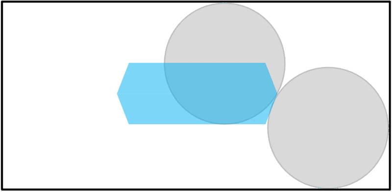

View attachment 358524If the pucks are identical, we know that their CM at the time of puck-to-puck collision is at the point of contact. This allows mapping the region where the CM can be at any time. It is shown in blue in the figure on the right with the pucks at one of the extremal positions. The ratio of the tube width to twice the tube diameter is 7/9. To describe the motion, one can imagine the CM bouncing elastically inside the blue hexagonal area and then write some equations.
I made supplementary explanations to the question in post 50. I would be extremely grateful if you could take a look at it.
  • #52
The CM will not bounce elastically.
Total energy is conserved, of course. But that total energy can be seen to be divided into the bulk kinetic energy of the center of mass and the internal kinetic energy in the relative motion of the individual balls. The relative velocity of the balls is not constant. So the internal kinetic energy is not constant. So the center of mass energy is not constant.

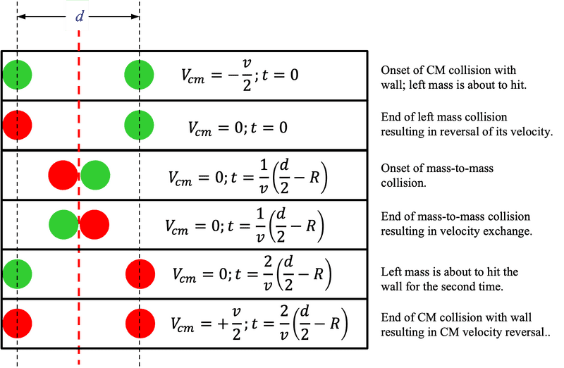

Shown below is a sequence of frames illustrating the collision of the CM with the wall. The balls have equal speeds ##v## along the horizontal. Velocity arrows are omitted to reduce clutter. The color code is: Lime green → moves to the Left; Red → moves to the Right. The CTC (center-to-center) separation between balls is ##d## and the red dashed vertical line is parallel to the wall at the point of closest approach of the CM.
The onset of the collision of the two-mass system is when the left mass hits the wall at ##t=0## as shown in the first frame; it is over when both masses have reversed direction and the information that one part of the system has collided with the wall is transmitted to the other part. This is shown in the last frame. The collision duration is ##\Delta t=\dfrac{d-2R}{v}.##
This is a simple 1D example with the common velocity in the CTC direction. For a tube of length ##L##, the period of horizontal oscillations is $$T_{\text{hor}}=2\times\left(\Delta t +\frac{L-2d}{v}\right)=\frac{2}{v}(L-2R)$$and is independent of the separation ##d##.
Similarly, it can be shown that if the CTC is horizontal, but the common velocity is vertical, the period of vertical oscillations for a tube of width ##W## is $$T_{\text{ver}}=\frac{2}{v}(W-2R)$$as the balls bounce up and down without colliding with each other.
I stop here. This is a live homework problem after all.
