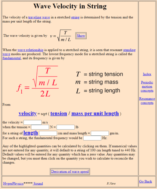

That "F" is the Tension force:
http://hyperphysics.phy-astr.gsu.edu/hbase/Waves/string.html

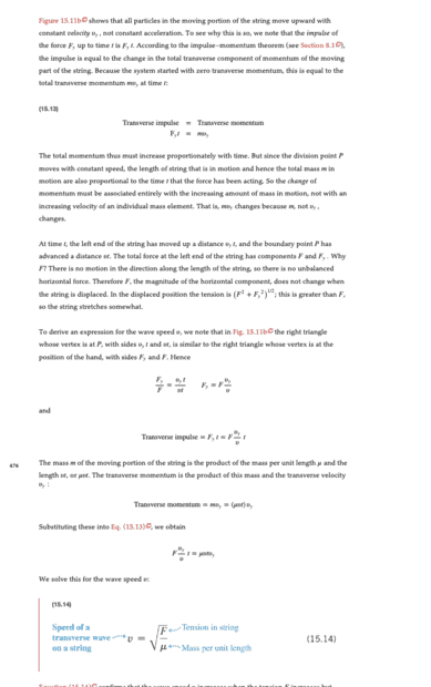

It does not matter. To the approximation that is used to derive the wave equation, the difference is negligible.

Ok, not sure how the tension in the x direction can be approximated as the resultant tension
The vertical displacement amplitude is assumed to be small in those derivations, so the tension in the string is not affected (in magnitude) by the wave passing by. Does that help?
For a typical steel string guitar a 2mm displacement at the midway point translates into an increase in string tension on the order of one part in one thousand. So it's a pretty good approximation to just assume that the tension doesn't change. Then you can focus on the vertical force and come up with a straightforward equation for the speed of the wave.
